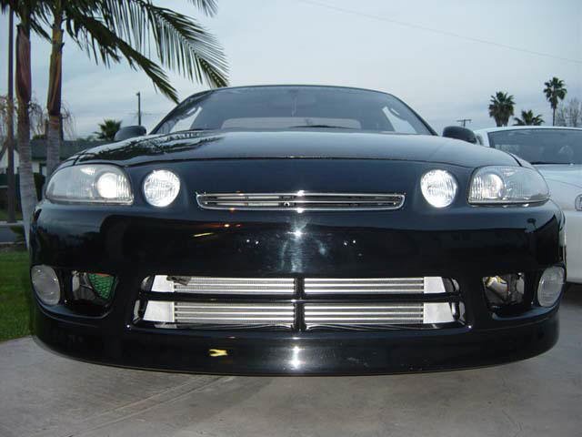

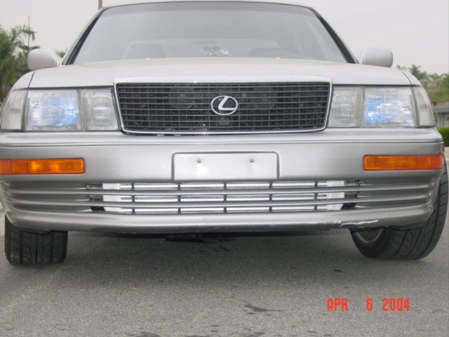

The below are two examples of FMIC. They are both custom IC specifically for LS400 and SC300 with 2JZGTE swap. I will try to find some W2A IC.
Here is a FMIC SC300 With 2JZGTE Swap:
Here is my LS400 with FMIC:
