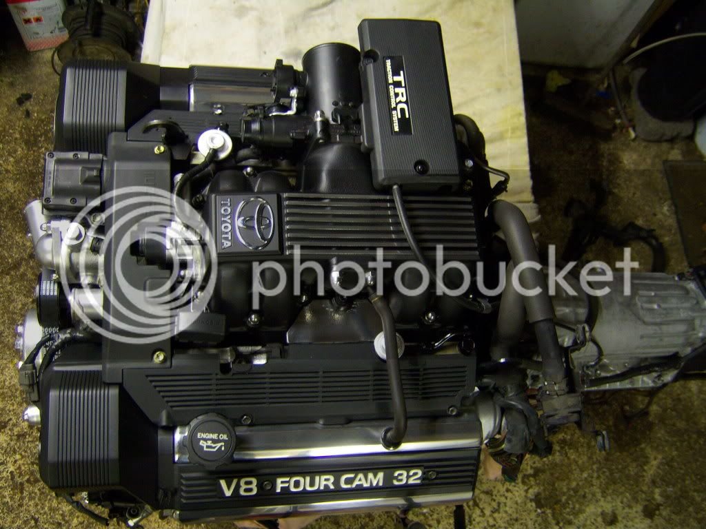

Here's one I'm working on at the moment, (number 7) as you can see it makes the top of the engine look cleaner with the EGR and all the other crap removed. The engines still run fine without it all by the way.

Got any photos of your engine? I have a 1996 V8 here that has a different AFM, thats about all I've noticed so far, haven't had a really good look at it yet.
I've only got one so far, I'll try get a better one tomorrow and find out how to either upload or I'll post a link up to my Picassa account. :)
