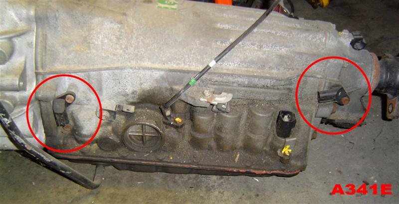

On the way back there is a loooong hill and i hit some bad traffic on it, when i got to the top I lost 3 and 4th gear. When the TCU tries to select 3 and 4th its like the far is suddenly in neutral. I got home and let everything cool down.
Went for a drive again, 1st(perfect), 2nd(perfect), 3rd(the transmissions still stays in 2nd but its now no longer in neutral), 4th(no drive, neutral?). When i poped my head under the car there was ATF all over the place, i had a very small leak at one of the corners but it was like 1-3drops per night, it seems the heat/pressure forced this leak open.
So I pulled the sump pan, clean everything inside, rinsed the solenoids in break cleaner and put everything pack.
Went for a drive again, 1st( perfect...and with cleaned solenoid it was much smoother to switch from part to 1st), 2nd(very smooth transfer), 3rd( still second, no change) 4th( no change, still neutral). Also after the drive I see there is ATF coming from inside the bell housing.
I will be pulling the transmission this weekend, does anyone have any suggestions of what I can check or do to fix my problem, or did i screw up real bad and need to buy a new transmission? Would i be able to fix the A341e with spares i can strip out of the 5speed from the VVTi(dont know what model, still wrapped in plastic)
Oh, I am running aftermarket TCU, very popular brand here in south africa.
Damn..sorry for the long post, I hope some one can help.
