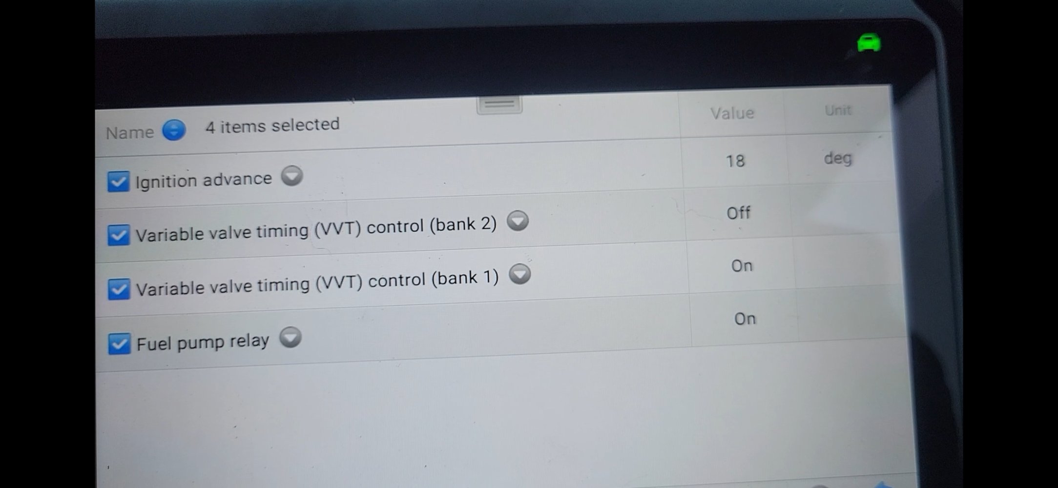

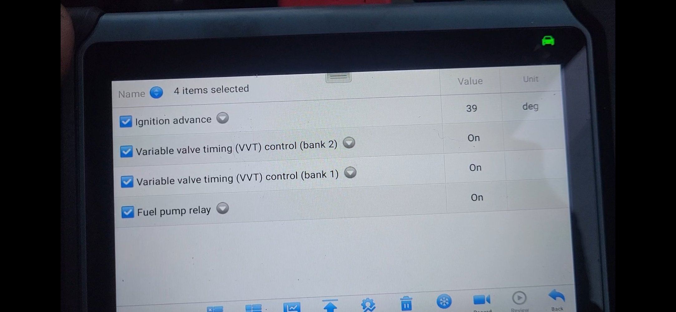

Today I was having a look through live data and it showed one bank vvti on, one bank vvti off?
Any thoughts before I pull the rockers and check valve clearance and inlet cam movement?
