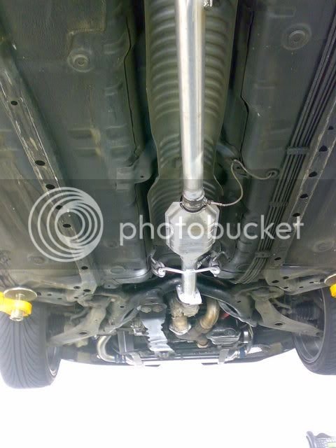

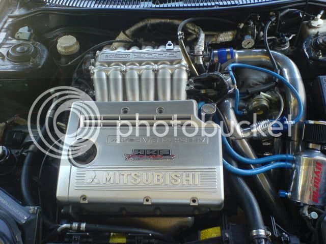

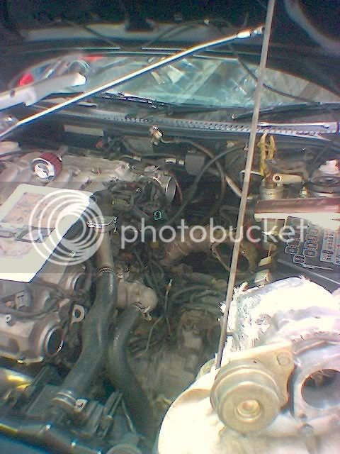

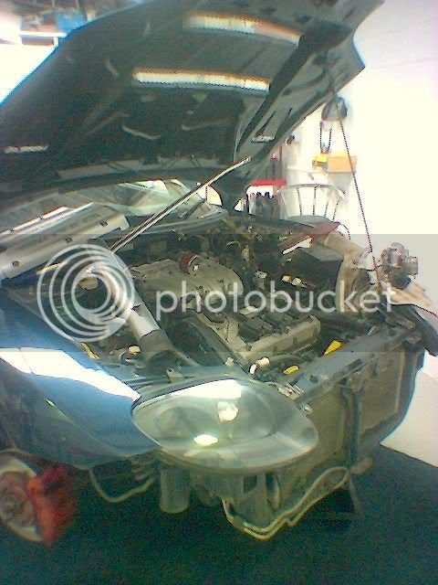

here is a few pics of my current FTO, to give you some ideas of what im trying to work with.

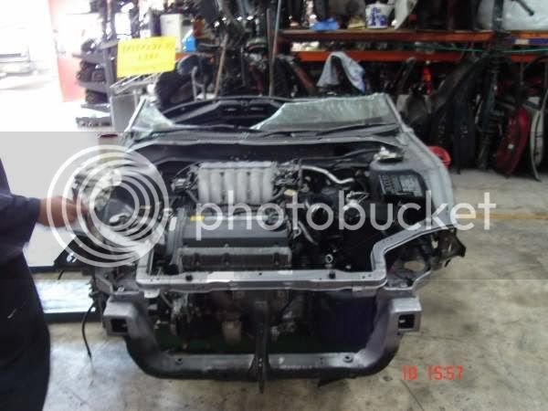

My spare halfcut:
