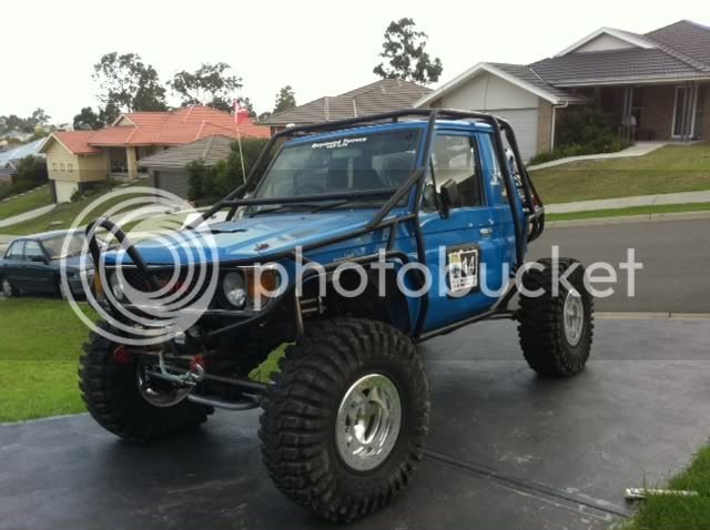

Hey mate, i have a cut down bundera i use it for hardcore 4wding and comps the specs are:
Engine: 1uzfe
Gbox: Ford C4 auto
transfer: Atlas 2 speed
diffs: 80 series landcruiser
ill post a pic up!
now to yours, what are you planning on doin with yours? airbags arnt going to be the best thing for 4wding you realise?
if you want to do some proper 4wding you'll need to put springs back in.
stock 80s FRONT springs in all 4 corners of a bundy will give you around 4" lift.
if you need some info shoot me an email! its on my webpage
www.energizedracing.com
Cheers
this is mine ;) oh its on 40" treps
