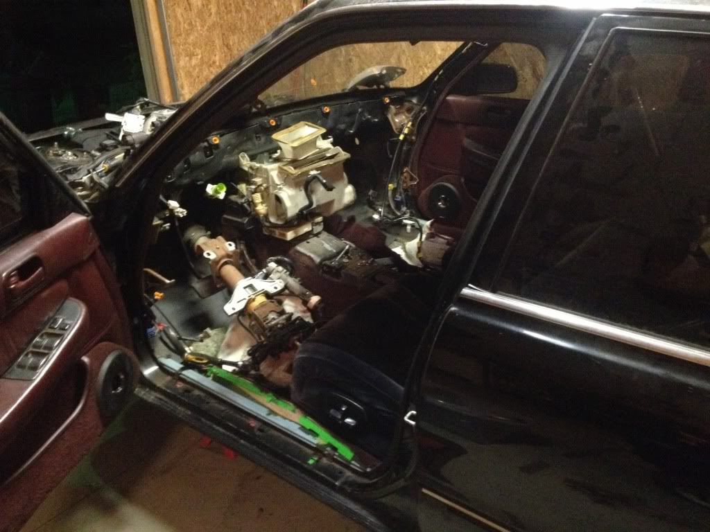

install interior harness/dash

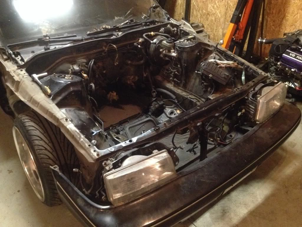

cut inner fenders and roll/pull rear 1/4

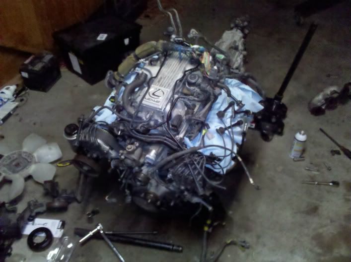

car running with a auto n/a 2j till one of the rods wanted to run away
started tear down

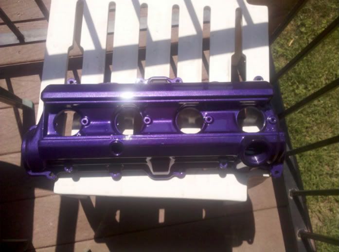

old man i used to work with made this purple its so nasty in person

how the pile is sitting now

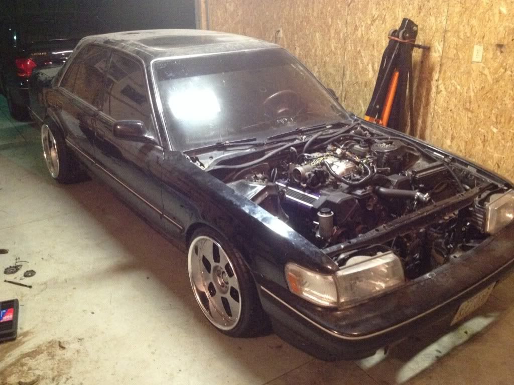

what im working with to get the wheels to fit
poorsupra
ive seen cressy fenders 3"+ with some elbow grease. should be able to clear that wheel no problem. keep up the good work
thejrman
Yeah it won't be too bad to do. I just need to do it. A buddy of mine doesn't believe that I can make them fit with little to no camber.
