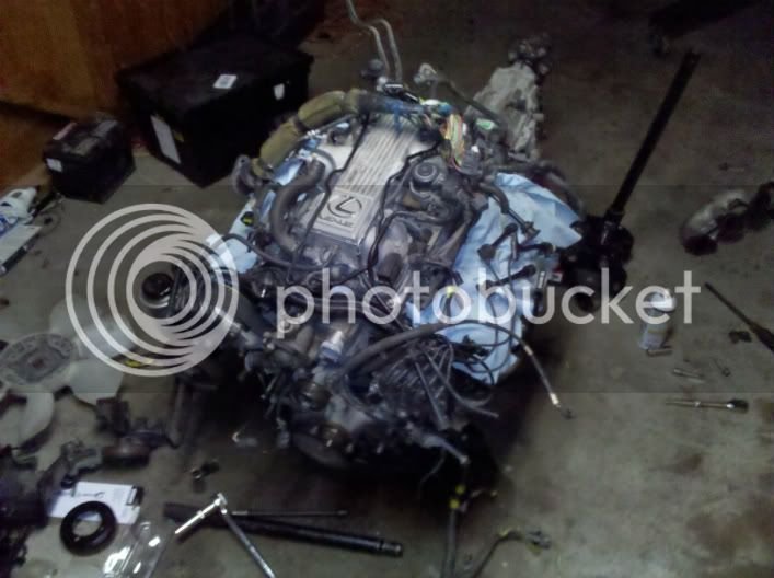

started tear down

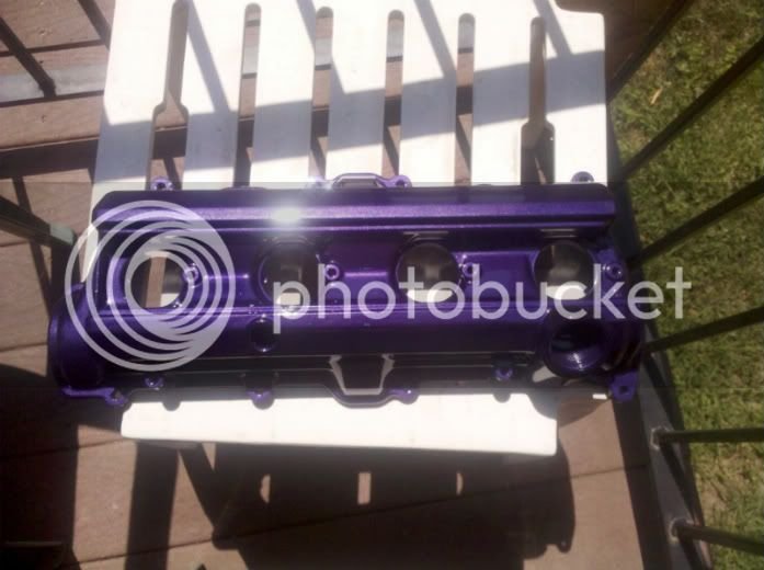

old man i used to work with made this purple its so nasty in person

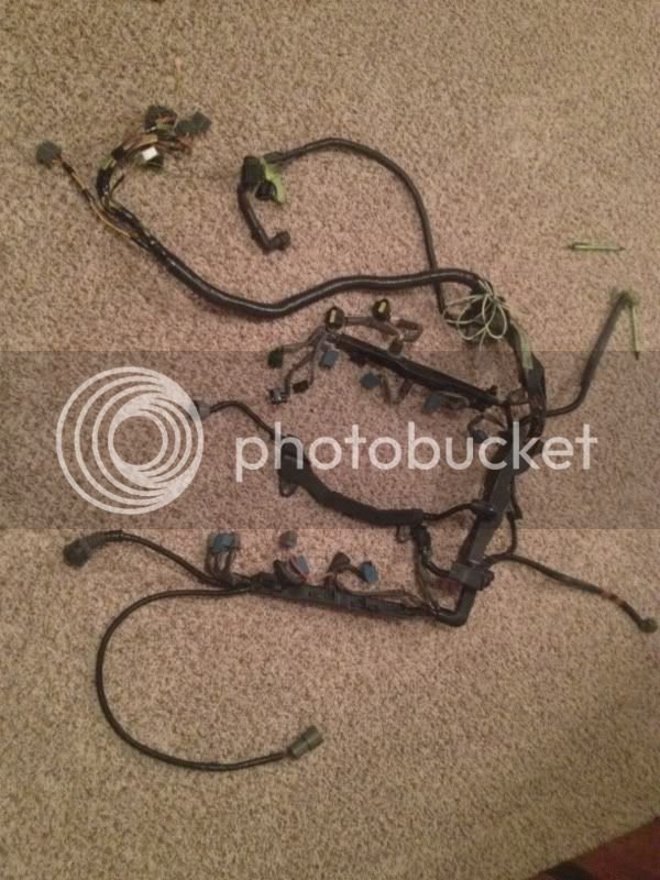

harness

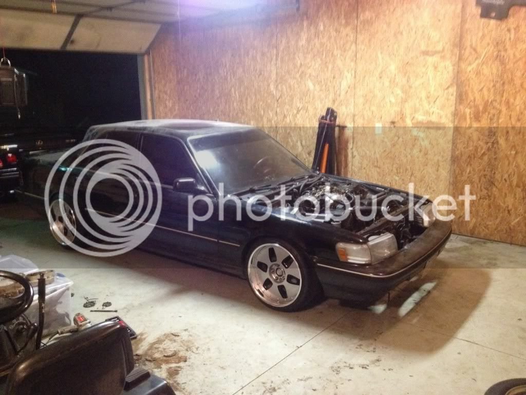

how the pile is sitting now
what im working with to get the wheels to fit

started tear down
harness
