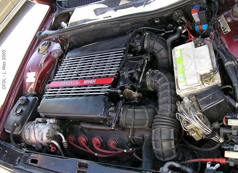

What about one of these then?
3 liters ferrari desinged 32v v8 (not a flatplane helas)
they where used in the lancia thema 8.32 and those go pretty cheap
Grtz Thomas

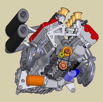

Here is another great looking piece of machinery. 2.8l - 400bhp @ 10,000rpm. I think it started out life as 2 x Hiyabusa's on a common crank. Big bucks though at around US$28,000......
www.H1V8.com

damn that car is crazy. i have thought about a setup similar to that before, its nice to see someone going for it.
few qualms though, such as the 75 degree v8 (if theres no width issues, 90 degree would be better wouldnt it?), and the inboard disk brakes (again, space issues i suppose..)

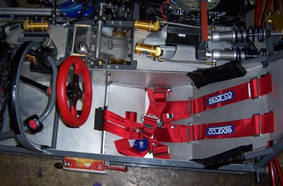

anyone know how the drive is transferred from the gearbox to the front and rear diffs? chain? and is there a centre diff?
whatever the case, 4wd and 970hp/tonne would be fantastic fun!
Most race V8's these days are 72 deg, single plane (180 deg) cranks, more efficient exhaust, not worried about passengers feeling the vibration.
Inboard brakes - unsprung weight, becomes more important the lighter the car.
Look up the entire build on DP cars, and you'll understand why he made the choices he made.
as for the brakes, in seven-like kitcar country we also ,if space permits, put the disk and calipers on the diff and it's craddle, for unsprung weight issue's. it's little harder to do that on a non drivven axle. one thing has to be taken into acount when calculating drive shafts and couplings, the entire braking force is aplied via the drive shaft.... Oh and heat.... lot's of it. older Jags have it like this and lots of older Hewland boxed racecars, but somehow they discarded the idea and now are back to in wheel.
and yes there's a diff in the middle right here (alloy casing inside the tunnel) dp1026.jpg
