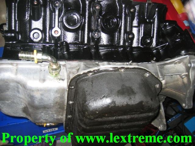

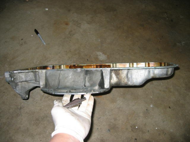

That is a rear sump. I have been meaning to put all three sumps together and photograph then as I have examples of all three in my shop at the moment. Somehow I managed to end up with two rear sump motors as well. Cheers

Take tinsump off and sit engine in place where you want it then you will know what sump is needed. easy enough to make a sump to fit if need be, just got to change oil pick up to suit. I am considering dry sump then there is no hassles a little more expence, and oil tank in boot. But no oil surge and oil changes real easy and oil filter remote in boot and oil cooler easy.
