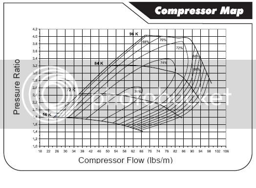

Check the flow maps* ... This is the cheapest B/W you can buy.. Yes the turbine is big .. You can get them with T04 turbines at extra cost..
There's a lot off difference between dd.. Daily driver and race..

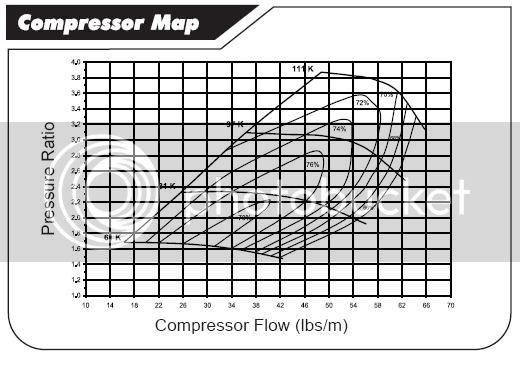

An S372 T04 .83 would spool nice for street driven car.. For just under $2k..
A 362 map ..Efficiant runing 500+ h.p..
A bigger S372 Efficiant 700 h.p..

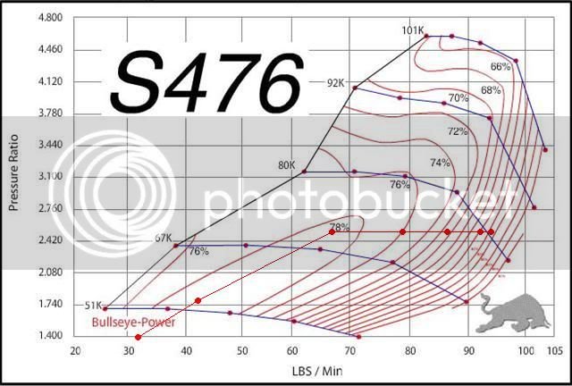

The S476 is $780 to the door.. The S480 is $1450 to the door with 1.10A.R T6 ...
