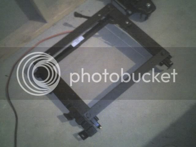

Just placed my order with Corbeau and ordered 2 LG-1 seats in black suede and (2) adjustable 3-point harnesses, and red pads. The straps have a locking mechanism thats keeps them tight but flip a switch and they have a ratchet effect exactly like OEM belts. Perfect for daily driving. the best part is the belts' harnesses bolt directly to the seat bolt holes, no need for a harness bar. The sliders are 4-6 weeks which is crazy but that what I get for modding a 17 year old car. here's some pics of the goods.
I have these belts in black, yellow is reserved for civic's only hehe
Sorry for the delay, here's some pics of the slider and fully installed.
One nice feature i found was that Corbeau sliders have mounts on the sides to mount your old seat belt lock so when you get pulled over you can swap from harnesses to OEM, already tried it!! The sliders are very strong.. stronger than the oem slider and lighter. The ratcheting 3-points are well made and mimic oem ratcheting perfectly... just enough room while strapped in to reach into your back seat. These have a specific design you can run harnesses through the back and mount them on the slider itself w/o the need for full race harness bars. Sliders were $100 each for UCF10 and took 4-6 weeks. Seats hold you in like coffins!

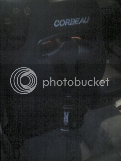

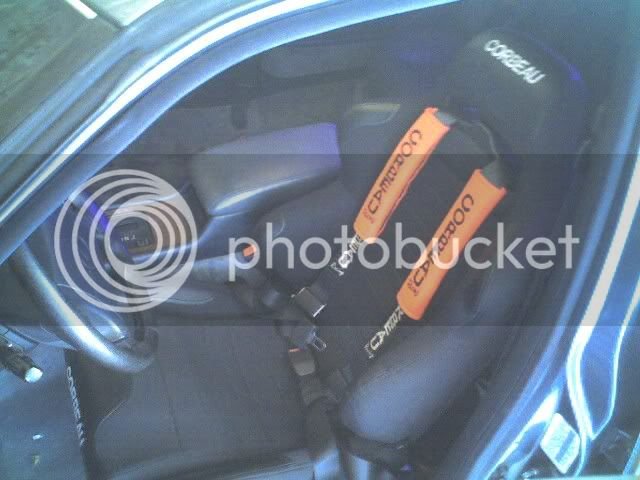

hah, yeah they hold you in, very comfortable for how stable they are. All corbeau seats have wide versions. Pretty sure the standard width on all is up to 34'' waist and the larger size goes up to 44'' waist. It's nicer driving with this seat just because the oem moved me around so much it was hard to take anything quick and feel controlled doing it. The sliders are for sure lighter, I would guess by 10 pounds and bolted in perfectly. Made of steel and slider arm isn't obtrusive. Bracket has bolt holes for oem belt lock. The seat itself is about 1/3 the weight and reclines farther than the electric ones did.
Sorry for the super dark res but all I had. These are technically 3-points because the back 2 are combined into a single belt that coils into a seat belt lock that bolted under the seat. Wherever the mechanism finally bolts up the side will "twist" and aim the arrow straight up and that sets the gravity effect so the lock/unlock it correct.
those seats are really nice!!! but what did you do with all the electrical stuff that was in the old ones? i have a 92 ls400 and its got the heaters and all that crap and my seat just recently broke doing the twist thing that yours did.
