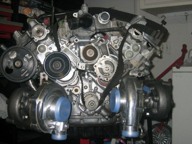

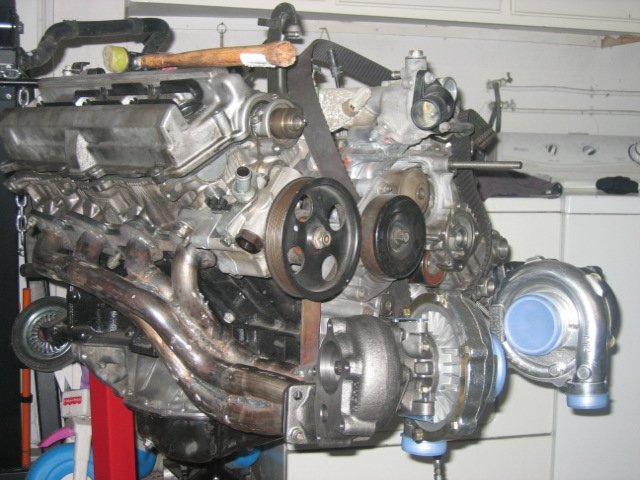

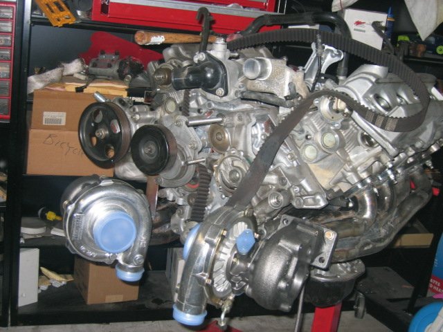

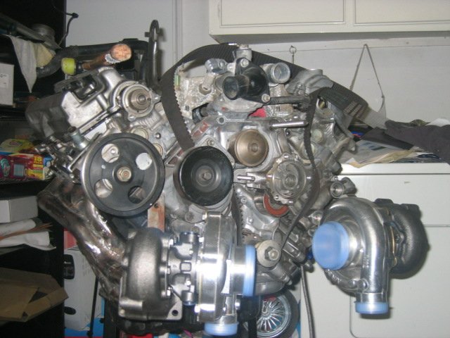

Here I am just playing around with cheap China made turbos. I had a T70 from my friend's shop and exchange it with a T3/4. I add little more money and got another one. So now I have two T3/4 and they are good for like 375 hp each. I installed them into my SC470 motor and here are some pictures.
I most likely would not use them. I think the hot side is .64 A/R. My Garrett T04S is .48 A/R with 60-1 compression. I need to get another one like the one I have and start making the rest of the turbo parts like WG and DP.
