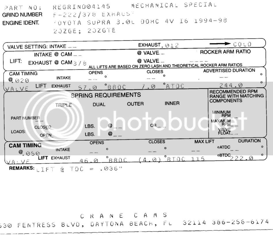

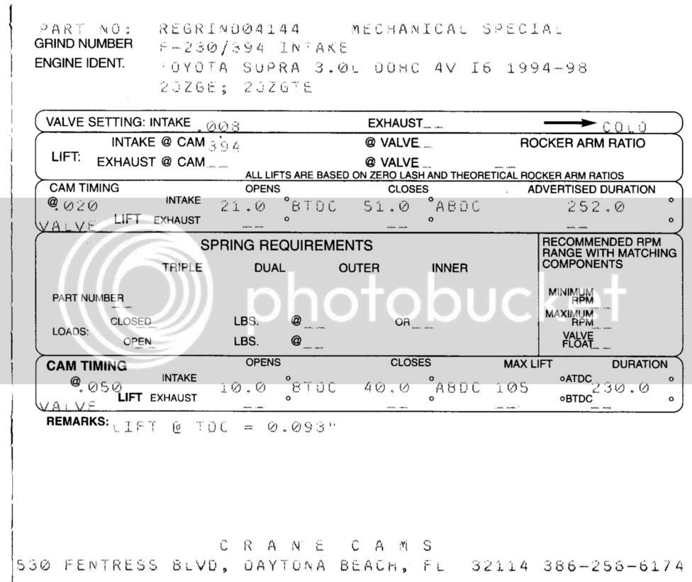

Hmmmm...I know the with the 2jz-gte, the max lift without becoming an interference motor is 10mm. I'm looking for a very aggressive cam set-up with any 2uz-fe that would go in the Supra, much like with the 2jz-gte that's there now. Here's the cam sheets.
You can see that the duration is very short compared the amount of lift compared to something like HKS cams. I'd like to duplicate this in a quad cam set-up with a 2uz-fe.
