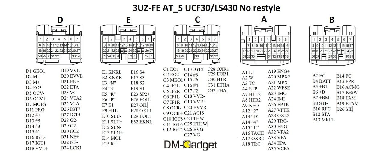

Hey guys, I'm preparing to install a Bee R rev limiter on my 2002 LS430.
I have the ECU pinout (linked to post) but I'm seeing that there's multiple ignition firing signals.
Does anyone have any experience with this or have a solution for this issue?
