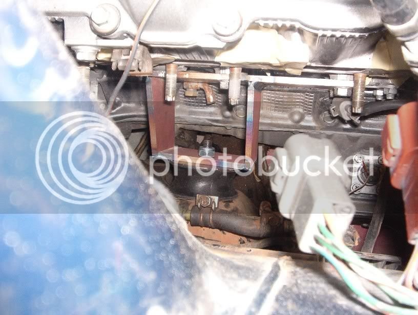

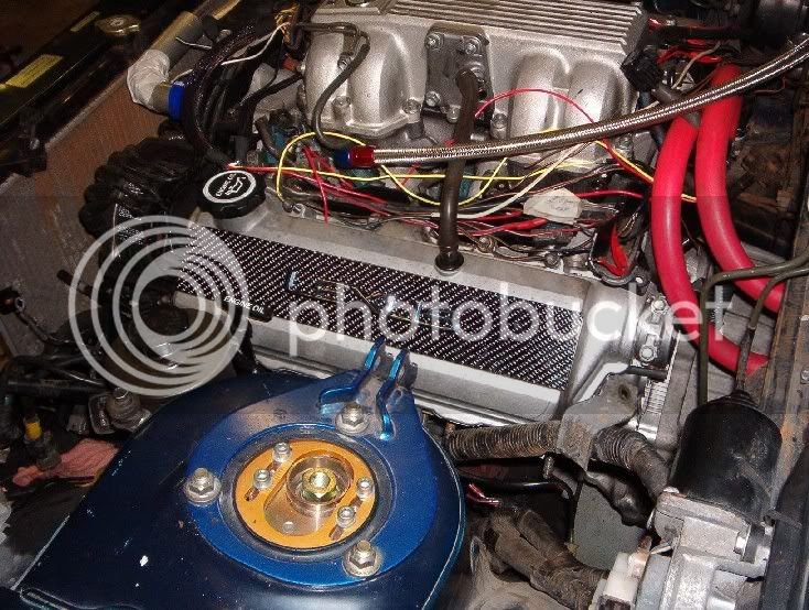

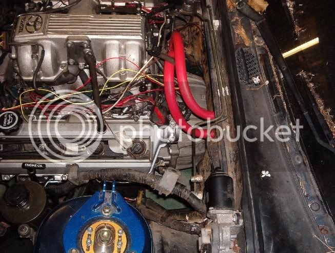

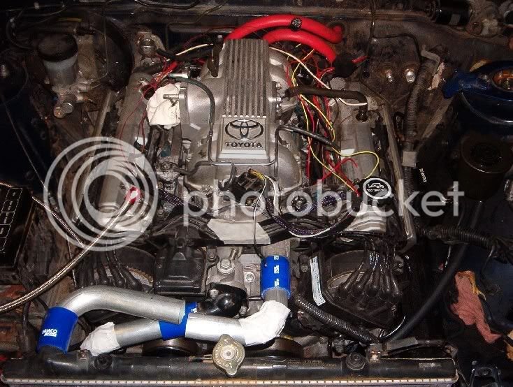

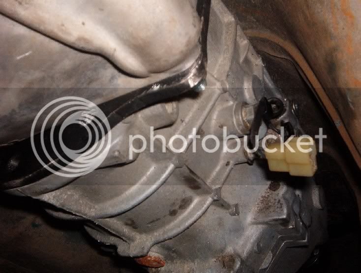

Ive got the motor and box mounted now unfortunatley the shifter is about 25cm to far foward so ill have to make a remote shifter but thats not too hard. Its just the wiring to go before I can start it up cant wait to hear it.

last weekend I got the engine running in the bay it sounds very cool. Ive since taken it out to finish the mounts and get the clutch working. The shiter on my w55 came out too far foward so I swapped the shifter with one that came out about 10cm further back obout inline with the output shaft this places the shifter about where I want it but its still a bit foward of factory.
I bolted up an r200 diff on tonight so hopefully that will hold the torque.
The goal is to have the car driving by the end of this coming weekend and then Ill do the exhaust after that Ill post more pics once its rolling:)
