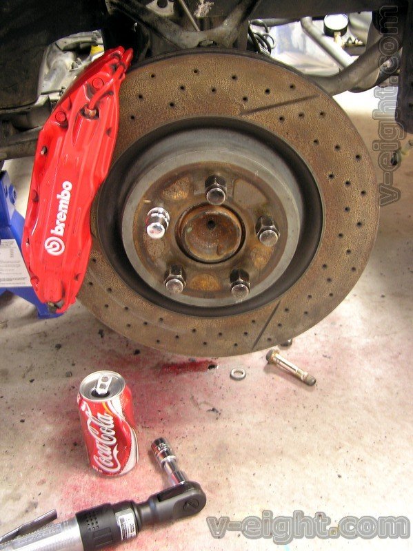

ED - Brembo big calipers in combination with Brembo D/S rotors would be sweet, expensive and the best... My SC4 really stops well with this setup and is night and day compared to the stock setup..I am no longer looking for an upgrade... The D/S rotors make all the difference I kid you not.....

rotors are are the correct way around, but calipers are backwards... j\that photo just a mock up ;)
your right the calapers are on upside down too, but now it looks like both situations exist. both the rotor on the wrong side and calaper on upside down. but if its mock up who cares.

Eddie - You better start driving that car around because you are developing surface rust on those rotors from non use... It's like a cancer as it starts on the rotors then travels to the suspension and then sub frame, bumbers, paneling, and then in cabin where it can run up your leg and arms while your driving...It gets ugly and bondo patch won't fix your legs and arms... It's a rusty cancerous mess to say the least so don't let it get the best of you.....:sigh:
Oh and by the way that Coca Cola sitting next to your Brembo's will also give you cancer after years and years of consumption and that is something I am not joking about..... You're better off drinking a cold brew and catching a buzz while torquing down those bolts, ditch the soda's you'll live longer......:fing02:
