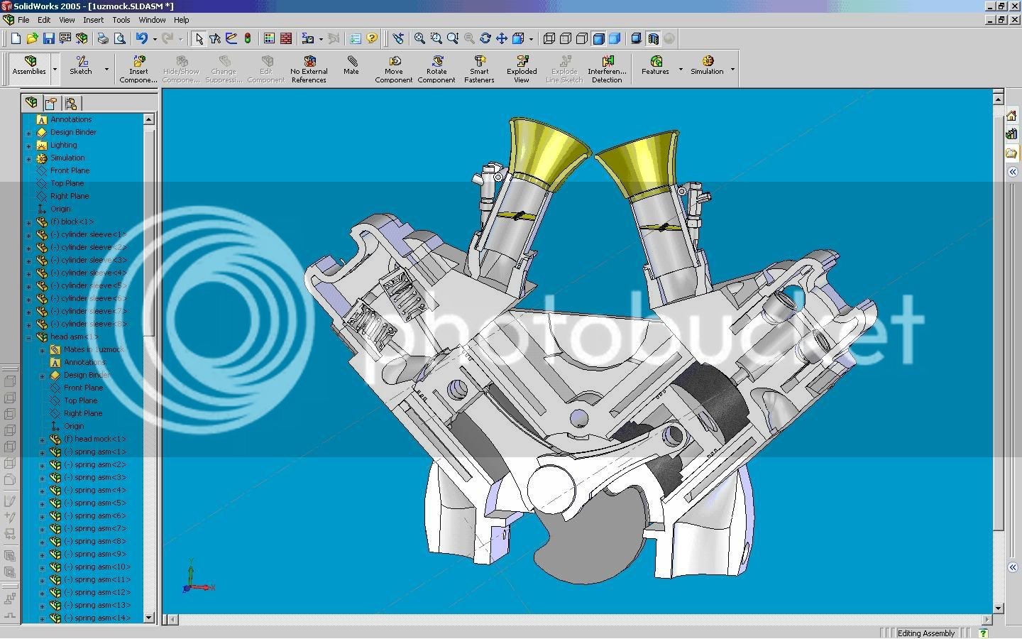

Hey everyone,
I just bought a pair of Suzuki 750 throttle bodies in hopes of using them on my 1UZFE as an Individual Throttle body setup. Here are some photos, they are ~49mm on the outside and 42mm on the inside. I picked up both of these for a total of $122 shipped to my door for both. Think they are usable? They look quite small when on the engine, anyhow, here are the pix -

They look tiny....
Too small? As for the spacing between each throttle body, you can pull this entire setup part and space them as you like, but you will then have to redesign the linkage between each throttle body

So, thoughts, ideas?
