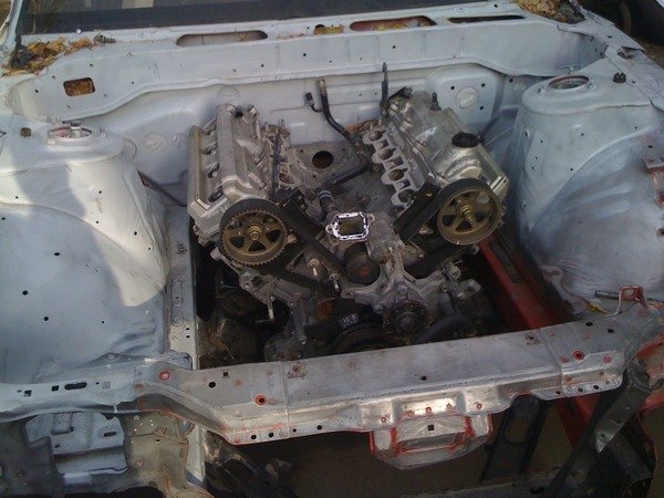

2 weeks ago i bougt this S13

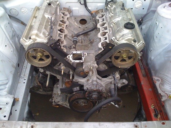

And today i think that tis crazy project started because today i bought 1UZFE from crown-majesta. This engine is not very popular in our counry yet but i think that its very goog engine for everything
ECU will be Autronic SM4 wiht spliters from 1MZ+ Autronic R500
My rims
I will be glad to listen your advices.
Thanks))) Exuse for my english)
I use Autronic because we know this ECU wery well. I dont want turbo this engine now. may be next year. it will be better to change ECU now than do it next year once again. I want to drive atmo at first and may be make 8throttle
Do you know must we change cams. What specs will be better for atmo 8throttle?

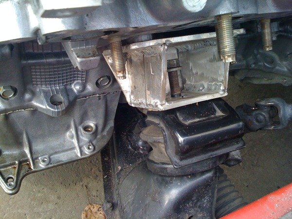

The fitment of your engine in the S13 is phenomenal. Are you planning on modifying the oil sump any? Have you had any issues with the front sway bar yet?
no offense, but rubber mounts shear off in an accident, = dangerous in race cars. the bond between the metal and rubber comes away. They might be TRD but it's what they are that I see is the problem. I've seen thousands of crashed cars (literally), I know what I'm on about.
That's an interesting point and I for one never thought about it that way, thanks for the info. :) Ill have to re design my own S13 mounts... :sleepy:
