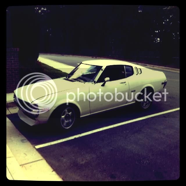

Hello, this is Timmy from atlanta, ga. I have a 77 toyota celica currently doing a 1uzfe swap. Did quite a bit of study thank to this forum and i thought its time to say hello. I'm still quite the noob on the 1uz but from what i seen and read so far lead me to purchase one myself.
So far the 1uz is just sitting at the shop. But will be starting quite soon. If some of you can help me out, please answer a few questions for me. I searched and searched but didnt quite get the right direct answers. Will the 3uz heads and intake bolt to the 1uz bottomend?... also doesnt the 3uz have vvti?.. how would that affect the non vvti 1uz bottomend?.. rwhp gain?..
