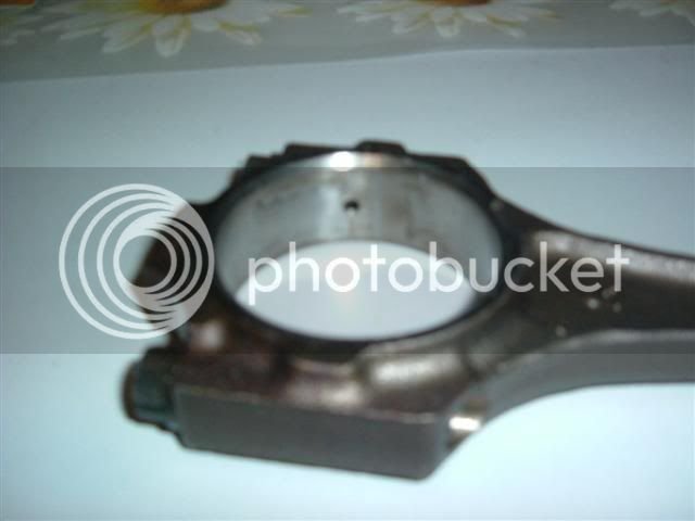

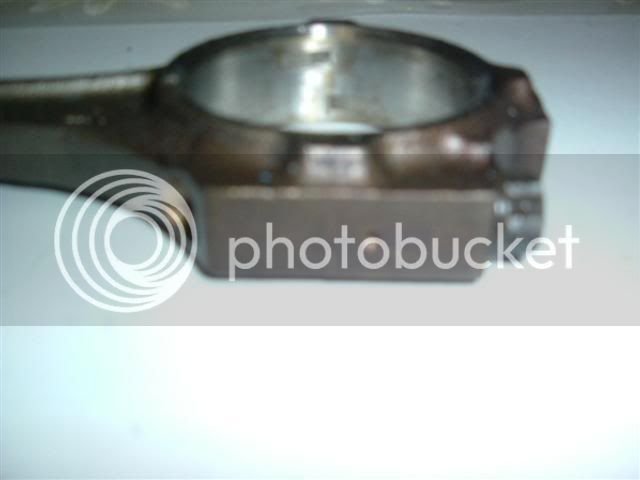

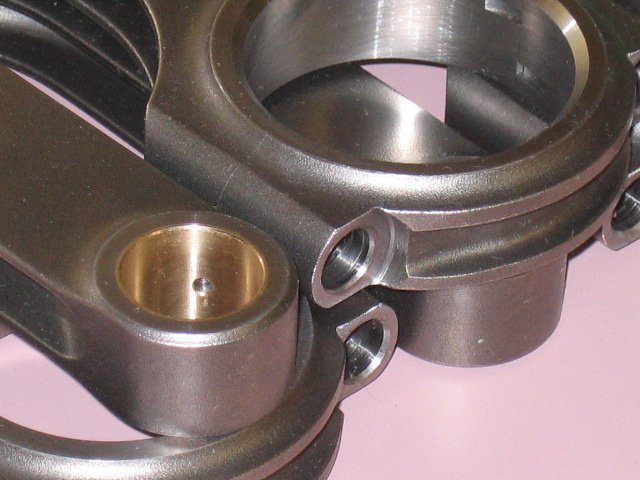

Did you notice on the stock rods there is a hole that lets oil squart on opposite cylinder ???

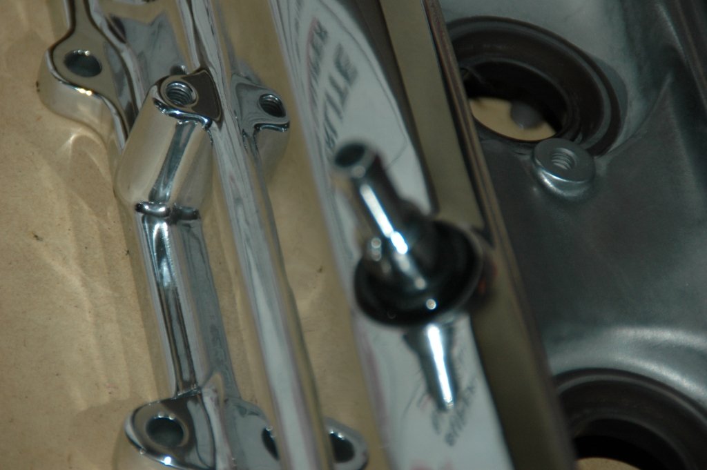

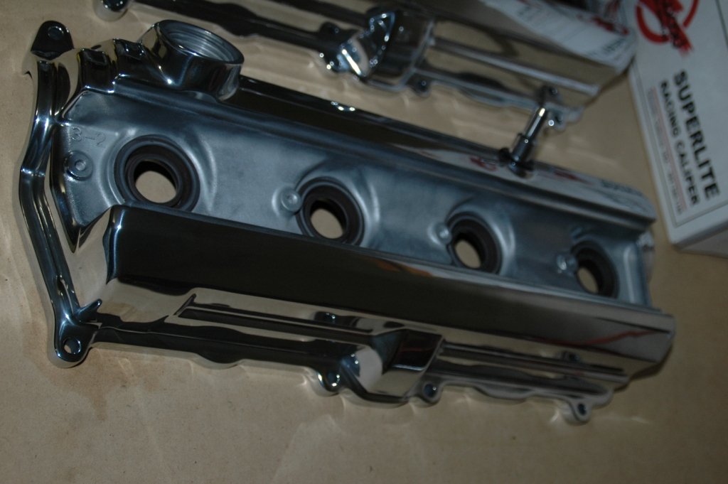

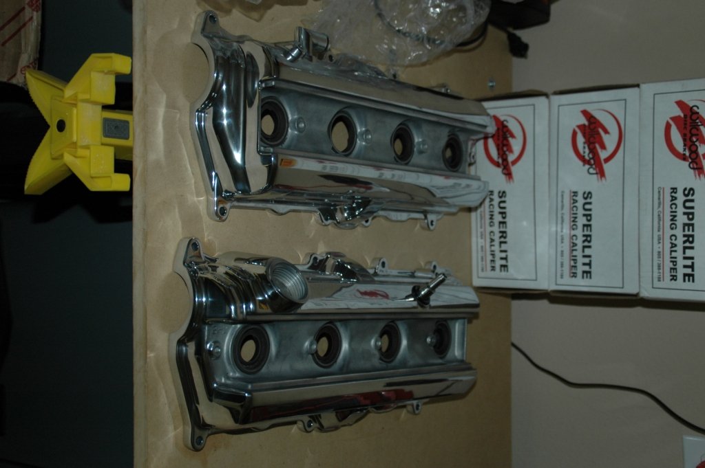

Gang:

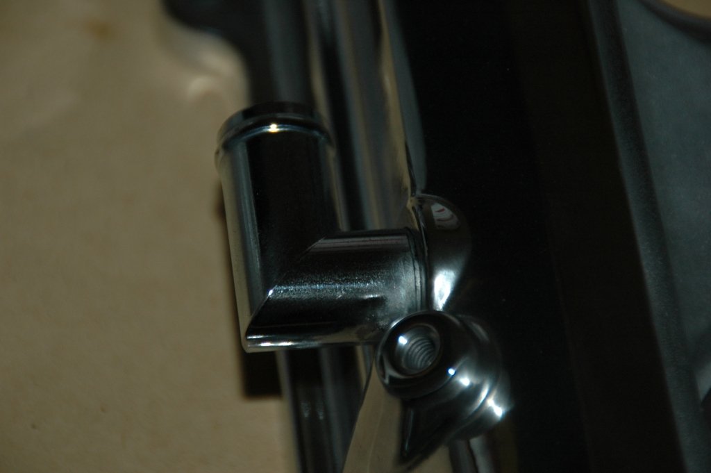

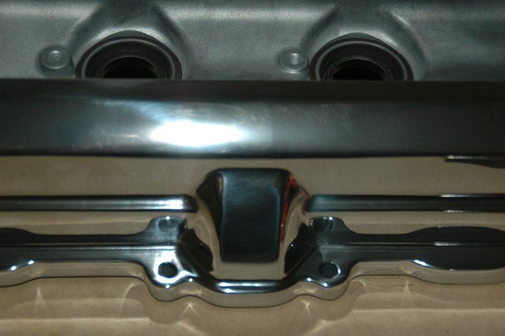

Attached are the polished valve covers...Look like mirrors...thumbsup.gif Many more cool things to come...biggrin.gif

I'm still new to the whole 1uz scene so im not sure which are available or not =( right now im just researching since im planning on geting a 1st gen ls400 soon.
The Argo rods don't.. I'm not too concerned. With modern oil and top quality pistons with good tune I should be fine...
It would be more benificial on low rpm sluging along at low speed...
There's no chance my engine will ever be driven like that...
Not with 4000 stall, Powerglide and 4.1 gears... On C16...
And GT4202...

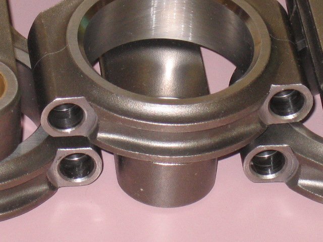

I don't recall if that pin hole was in the Pauter rods...But, I did notice that the pauter had chamfered the front and back face of the big end of the rod for better oiling properties, where the stock rod only did that on one side...
Ryan

David,
I'm drooling because of your rods.
