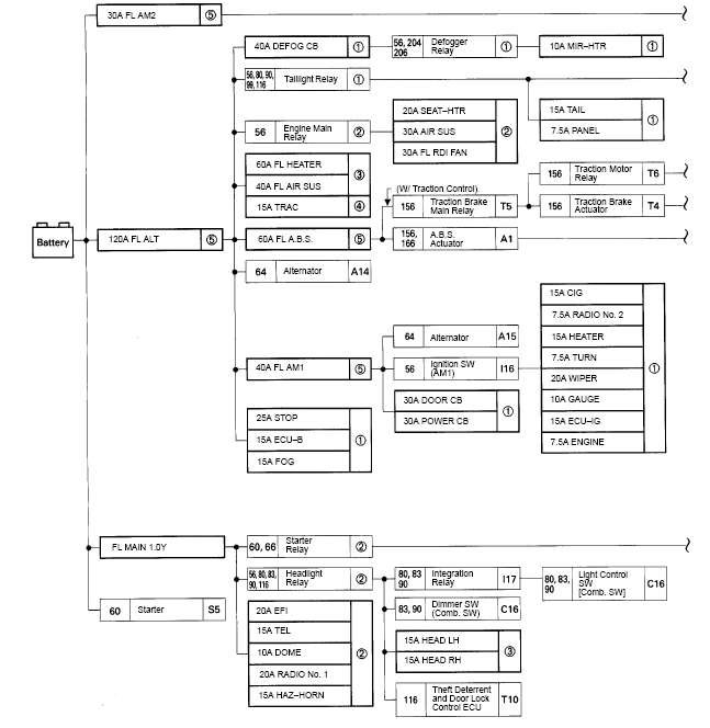

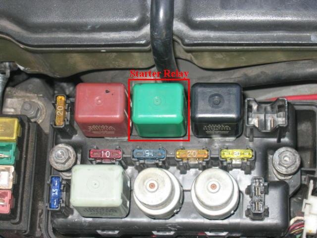

I was outside my car using the automatic start to start the engine and monitor everything. Suddenly my car wouldnt start and my negative battery terminal puffed smoke. Now nothing in my car has power. I tested the battery and its at about 12.6 Volts. I checked all fuses inside the car and the smaller fuses inside the engine bay. Is this just a relay that is broke? What would cause this problem?
