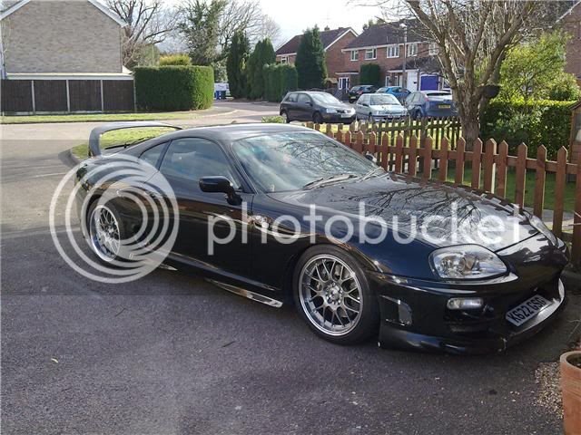

cheers for that , will look into it in the meantime il post a picture of my previous supra , i just wish i kept it :P
cheers dan
Nice Supra; I've never met anyone who didn't regret selling their Supra afterward. Was that a Whifbitz bumper on it, and is Paul still around?
the front was bomex but not to my taste , whifbitz are nicer and as far as im aware he is still around doing well producing good quality stuff
