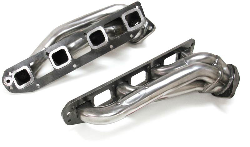

Even if I have to modify the collector or something like that, it will still be cheaper than custom headers. I was thinking about getting something like below, cutting it at the collector, extending it to where I want, and making it V-band. Gotta see if it clears the steering column though.
