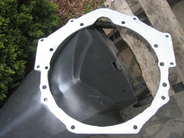

Hi,
I am getting an adapter plate made for a turbo 700/400/350, both box's were scanned in the other night into a computor so everything is spot on/centers bolt holes, no paper pencile here. Both images were put into a program called Solidworks, from here they were extruded and then mated. They are going to be made on a CNC Mill i will have one made up soon and then post some pic's. If we can get some interest i would like to set up a group buy which will bring the cost down for every one who wants one. will confirm prices later once we get the first one made. if you think you would want one leave a post.i have small video of a 3d model but it would not upload so a picture will have to do.
