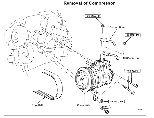

Peewee New Member Dec 14, 2005 #1 Not sure if this is the right section, not sure if it fits in any section at all? Anyhoo. I don't have a pic of the top of an LS400 compressor, only the Crown one. But which one goes which way?
Peewee New Member Dec 15, 2005 #4 Ah, excellent. Rear port goes forward, front port goes backwards (on my car). Thanks Lex.
