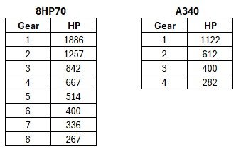

Currently, with 400hp at the wheels, the gear ratio multiplication equates to a theoretical:

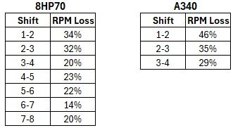

Further to this, with each gear change, there is way less RPM drop, keeping the engine on song

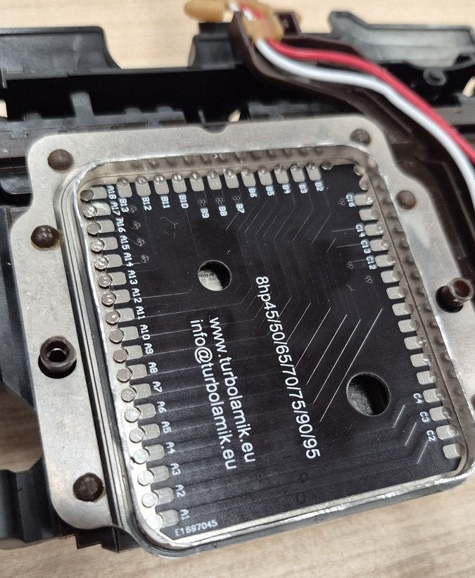

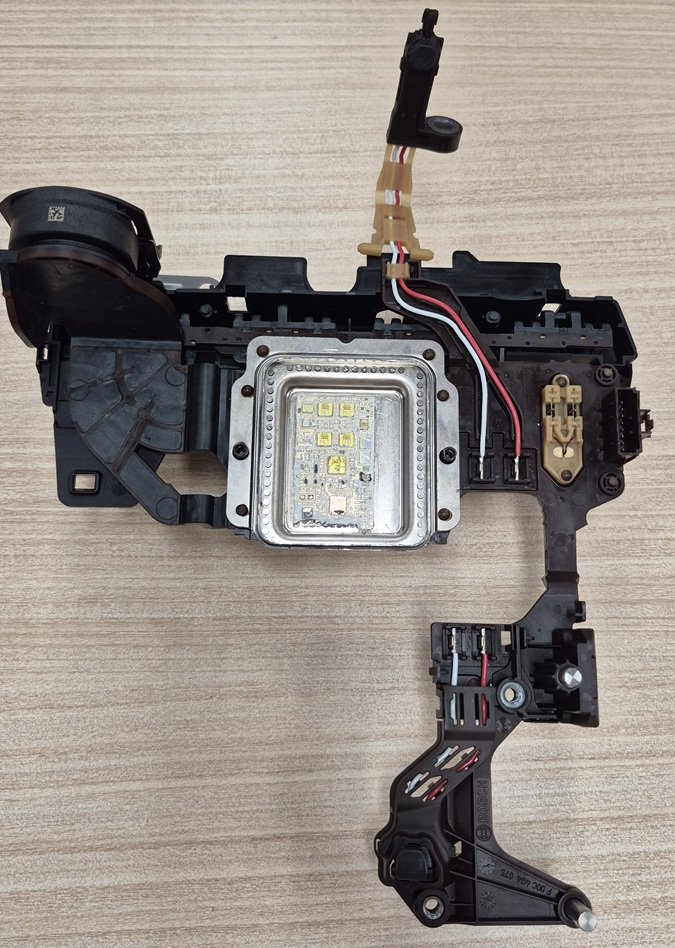

The next job involves removing the mechatronics unit and cutting out the factory ECU (inside the transmission) with a die grinder. With that out of the way, a bridging circuit board is soldered into place and the whole thing reassembled, ready for test fitting.
Cutting the TCU open with a die grinder required a good deal of patience steady hands but I got it done without any damage to the internals.
With all the internals scraped out, the Turbolamik board drops in nicely.
After soldering in all terminals, a quick check with the multimeter to ensure no short circuits or unintended bridges is good insurance.
The mechatronics is now potted with ultra-black silicon and reinstalled.

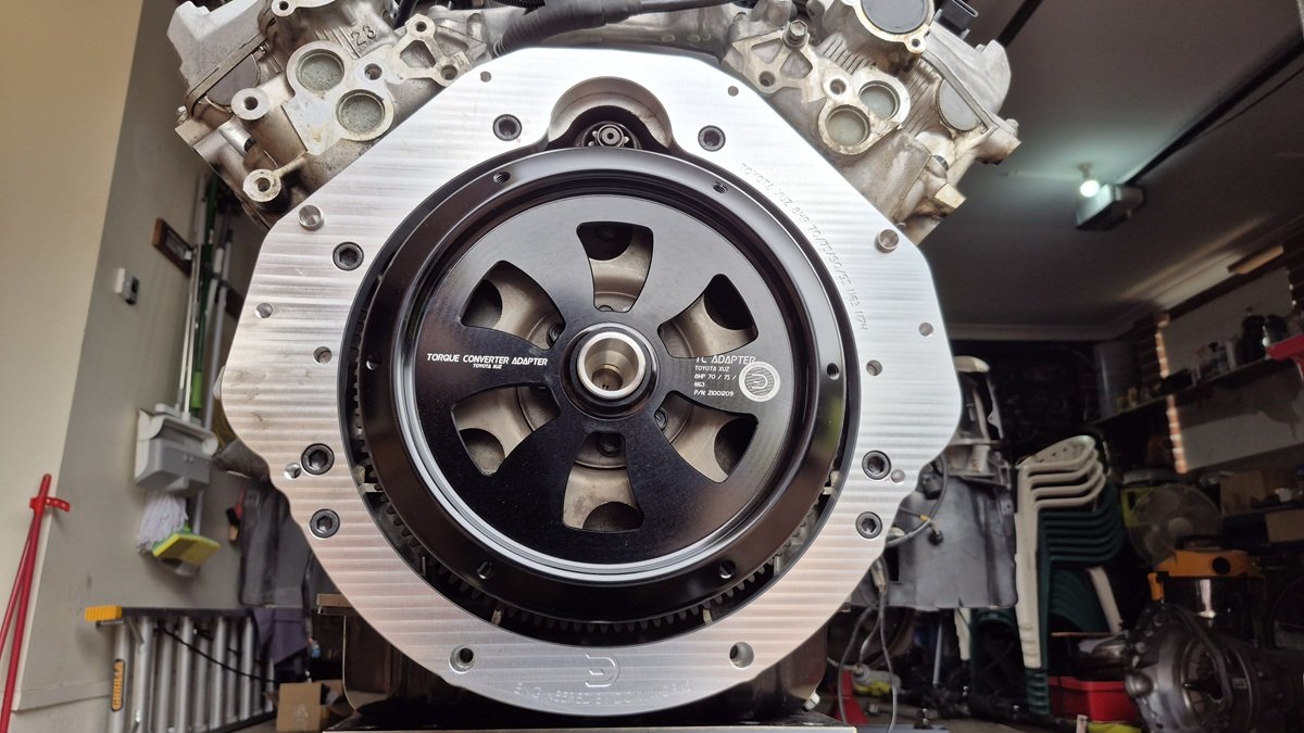

The correct adapter plate finally arrived last week, and I had the engine ready to remove in anticipation.
I've seen a number of 8HP swaps end in disaster because nobody set the driveline angles correctly. Mess this up and you can induce a driveline vibration so bad that the gearbox housing will crack.
Given the engine is connected to the transmission, measuring the engine angle first is a good start. When I make the new transmission crossmember, I will be aiming to have the same engine angle. I'll also run all the numbers through the Eaton driveline calculator to be sure its good BEFORE driving the car.

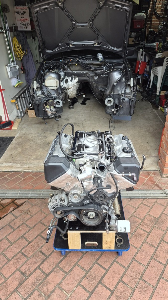

As I'm doing this sway in my garage, and I don't have an engine crane, I made up a dolly to wheel the engine and gearbox in and out.
It's rated at 450kg so I was confident it would take the load, however wheeling it around was precarious... if it tilted too much it would end up on the driveway!

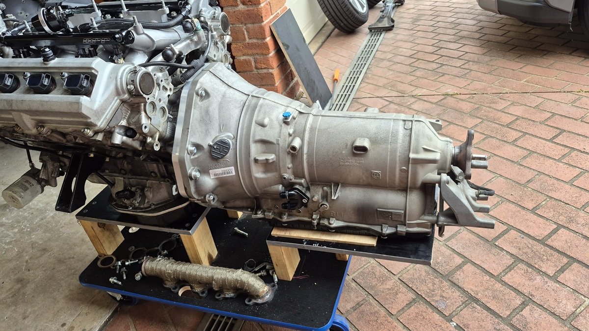

Domiworks adapter kit is exceptional. Everything fits perfectly and it took about 10 minutes to get everything (including the gearbox) installed.

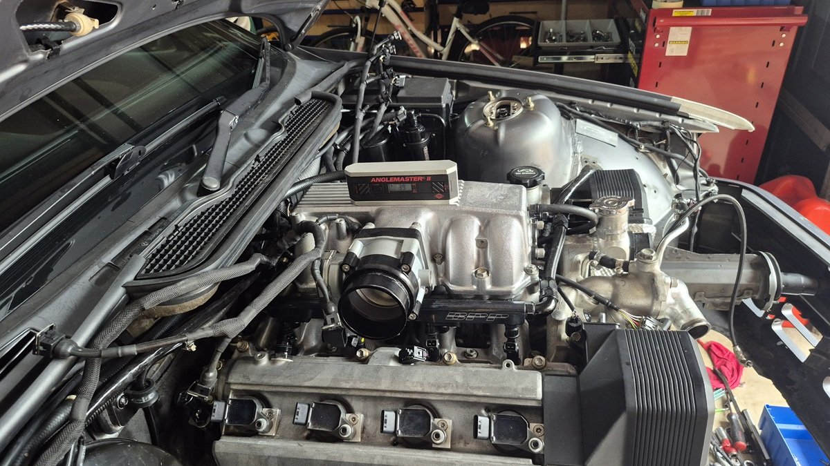

Not that I can tell yet Ivan - I'll bring home the Anglemaster from work and refit the plenum tomorrow night to see what angles I've got.
