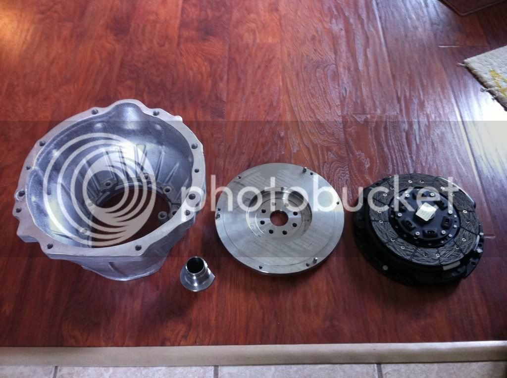

Billet flywheel and custom carbon kevlar clutch, pressure plate says 3230lb clamping force and is supposed to be good for 700hp
old automatic is out, swapped the ring gear onto the new flywheel and should have everything back in the car tommorow. Would be driving it tommorow with the 5spd but my luck ran out and the driveshaft is going to be 3" too short, fuck! oh well guess i'll be having a new one built again lol

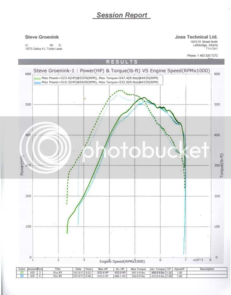

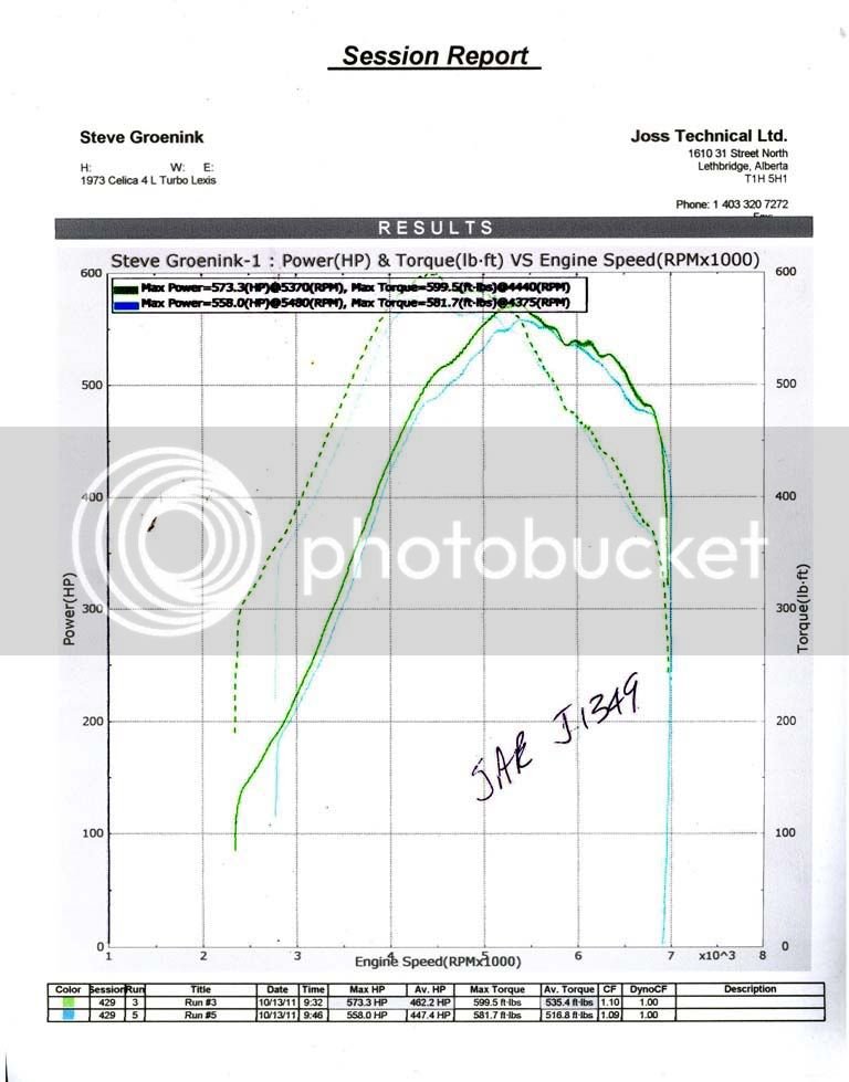

Intake Mani hasn't been done yyet, that was a dead stock motor but running 12psi. Original dyno was done at 8psi. Doing the math for 8psi vs 12psi, 1/4 mile MPH and weight it should be making in the neighborhood of [email protected] uncorrected or 485-490corrected to sealevel
numbers with intake manifold and 15psi should hopefully be 550whp uncorrected which should net me a 9.95sec which is my goal for this car
