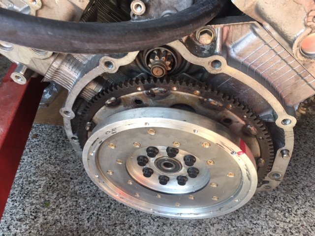

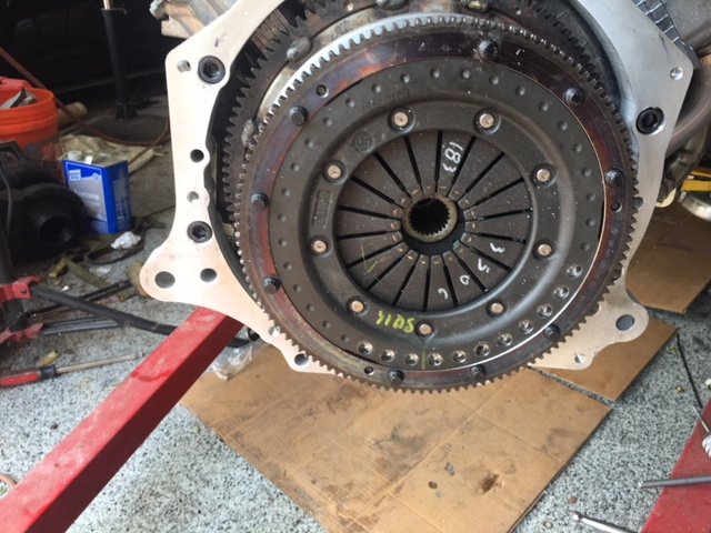

Shop made flywheel (from billet)
With twin disk clutch and trans adapter

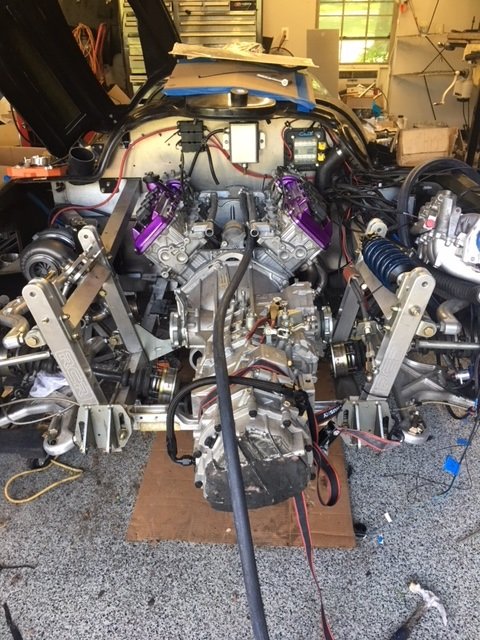

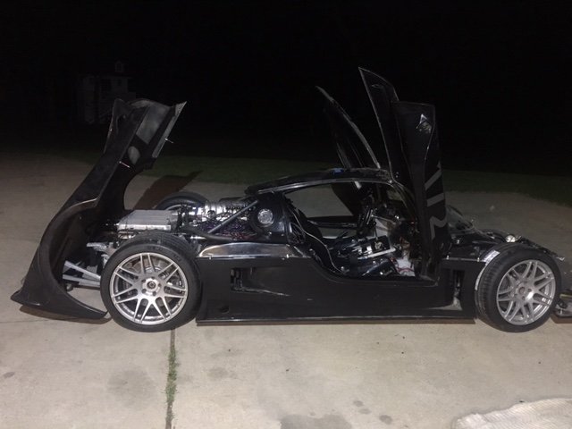

In the car

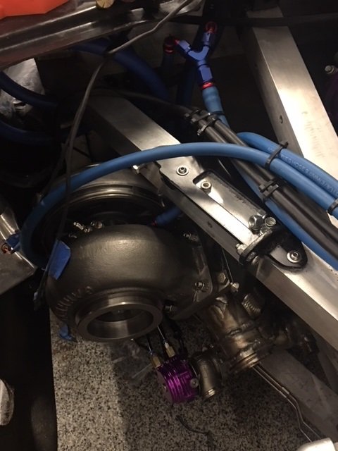

Side mounted twin scroll
All together
The car

New setup is a plumbing/wiring nightmare. Is setup for Flex Fuel and 32 lbs of boost with megasquirt, water cooled wastegates, water cooled turbo, three fuel pumps (one lift, and two staged pressure pumps), electronic boost control, pressure/temperature sensors out the wazoo along with wheel speed sensors on all corners.

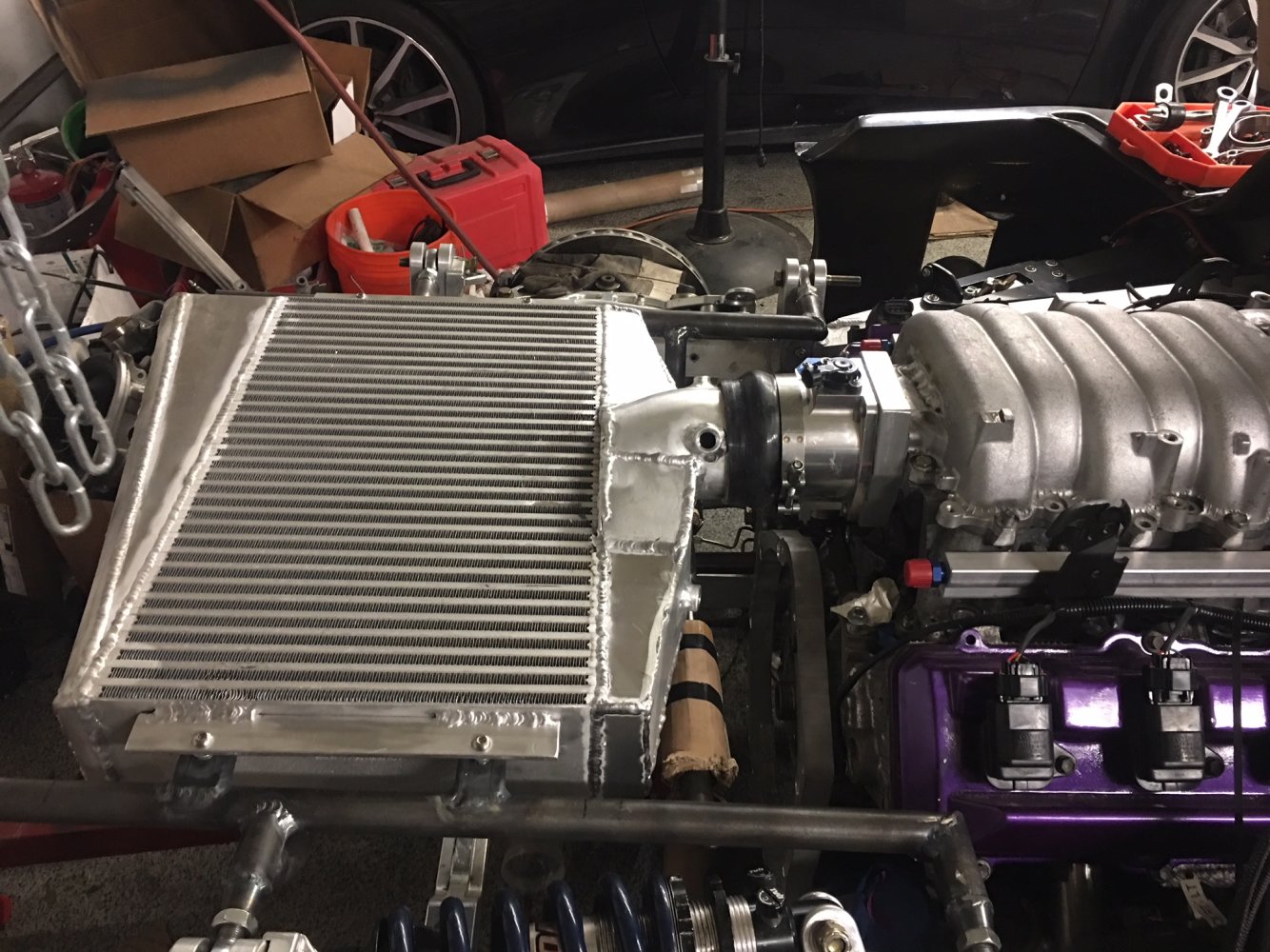

That'll be a BEAST :) Is that a water to air intercooler I see sitting atop the engine? Or are you using an air to air, hidden somewhere else?
Has it been dynoed?
That is the stock 1UZ VVTi intake manifold (with some welding, a 90mm throttle body and machining to fit standard 14mm injectors). Behind it is the intercooler I spent a large number of hours welding up. It sits above the transaxle and under scoops in the tail section.

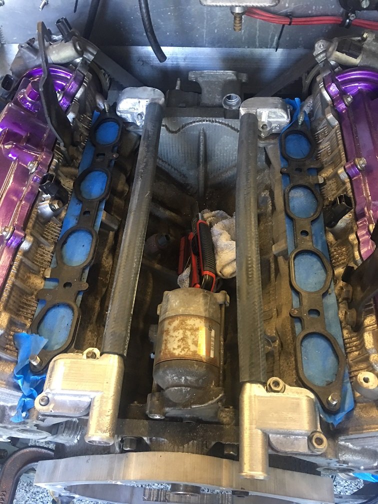

You can see it all in this pic, along with the fuel rails I had to make to feed those 1200cc injectors.

On the exhaust, there is a cross-over under the oil pan (behind the sump). 2.5" tubing. I had intended from the get-go to be dry-sump, but did poke the motor in wet-sump. That required removing removing about 1/4" from the pan for clearance. The motor is coming out in a week or two for dry-sump which will give a bit more clearance. I assume on a Lexus chassis the area behind the sump is frame. Fortunately on the SLC there is only one small crossover there and it's the actual motor mount.
Still trying to figure out how to fit alternator, A/C compressor and drysump pump and the associated drive into the car.

I am giving casting my own pan a go. Have not cast something this large so we will see how it goes. This pan is setup for 5 evac & 1 turbo drain or 4 evac and 2 turbo drains. Of course you could not drill all the bosses if you want less. I need 2 pans. If they work out I might be game to make an extra or two - but not looking to start a business.
