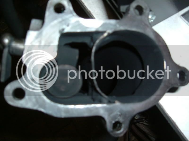

You're right. I see the internal wastegate has very small outlet hole. That's why I'm kind of hesistating to go for internal wastegate if I aim for more than 300 rwhp. However, I think the internal wastegate has its advantage due to its close distance for venting the boost.

99% of w/g efficiancy is the merging of w/ gate pipe design...Try to avoid 90* merging ... Yes we have had to port intergated 3540's and fit bigger flapper...Some porting on inlet turbine side helps as there seems to be turbulance that prevents good flow....
A mod tike this helps w/gate flow on intergated turbo's.. This is not a GT3540...
