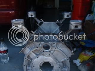

So I saw all you Rover guys doing it and thought I'm going to build a Jap one.
It's a fair bit harder than the Rover ones, what with the 90deg 'V' but it didn't take much to solve.
Just gotta decide on polishing or just silver powder coating....
Looks way faster than Zuffen's & my motor already. Must be the Bacardi injection system.
Very cool.
I must have a huge stroker crank to get the rods that far above the deck.
I have a spare block but I don't see my wife accepting it in the house and I don't need a coffee table in my workshop.
Besides I don't drink coffee.
If it's not fermented in some shape or form it isn't fit for human consumption!

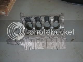

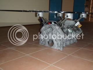

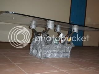

That is nice... Closer pictures of the Rods and block mounting.
At the front I just drilled and tapped holes, ran some 8mm stainless bolts and cut some small dia. stainless pipe on the same angle as the rod to space the bolt heads up, and allow them to sit flat.
I bolted a 6mm plate to the back and bent it in a falt bar bender, to mimick the shape of the front riser, and notched it out around the sleeves, whacked some 10x1.5mm stainless bolts into the head holes to hold it down and drilled and tapped the flat bar too.
I would have bolted them to the block, but then I would have lost a lot of height.
I'll try and get some more photos in the next couple weeks.
