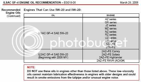

Edit: Found this chart, looks like Lexus approves 5W20 in the GS300, GS400 and GS430:
