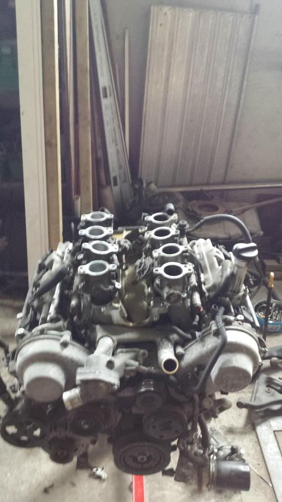

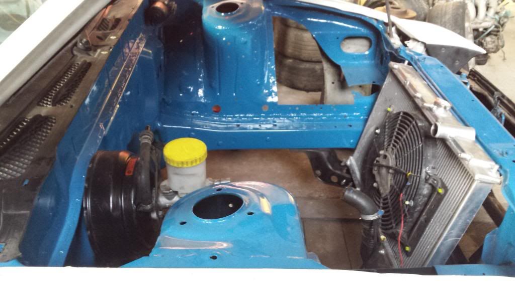

rite started building my s13 about month ago was toying with engine choice till i picked up a ls430 cheap so took chance on it
car so far

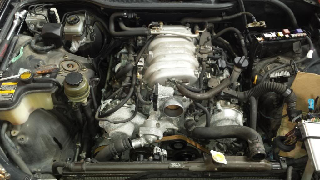

ls430 i bought for powerplant
took engine out n start stripping it have to get the ls400 sump convert it to frony mount also ordered adapter plate from collinsadapters waiting o that to arrive
played around with 4age itbs might not run these might go turbo
