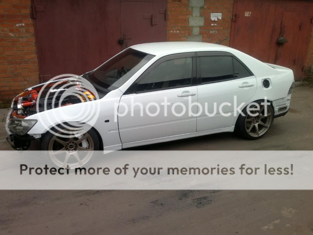

hey all. My name is Evgen and i'm from Russia. I'm a huge fan of V8 in general and 1uz-fe especially. Sorry for my english, i know that's really bad but it's not a big deal, right?
Let me introduce my SXE
It was almost full stock 2001 3s-ge tezza with mech gearbox.
i bought it and ride through six months. one day i thought " she is not as fast as earlier for me, and i'm sooo like american muscle cars with those bid and sexy engines, why not ?
Two years later i got this :)
specs:
  • 1uz-fe vvti from crown 171 majesta
  • j160 gearbox stock altezza 3s-ge
  • 3s-gte clutch from caldina st215
  • release bearing 1kz
  • custom exhaust with 2x63 pipes
  • 50mm engine radiator "chinapower"
  • full repaint
  • front brakes with 6pot calipers from porche cayenne and 355\32mm rotors from is-f.
  • rear brakes with adapted stock calipers and 307\16mm rotors from aristo 161
  • CST Hyperzero wheels 9+30 front and 9+23 rear
  • 225\40R18 infinity tyres
and a lot of other things :)
more information and pics later.
please- ask me your questions, i'm wanna improve my english and share about my car with you

Great looking car!
Thanks for sharing. Please add more pics of your conversion process. Engine mounts, adaptors, oil lines etc. The guys here love pics.
Keep us posted on your progress.
