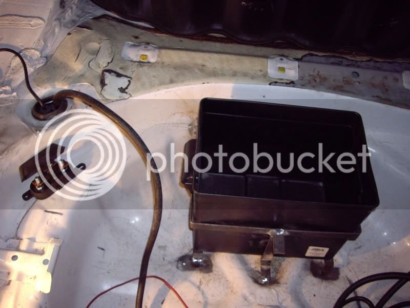

Finally have some pics, here is what I've done so far.
Cable ran under car
Up under rear carrier
Tight fit around sway bar
Into trunk with battery box
This is the fuse I was going to use - 150Amp, but there seems to be a debate here if it is needed.
Tell what ya think! Or if my car will burn down.
Looks good, Sideshow is right and in a perfect world you'll never need the fuse but that one a in a million where an intake manifold nut/bolt a previous mechanic dropped down beside the starter that grounds out between the +ve terminal and the engine block, when it suddenly decides to dead short you'll be glad you put that fuse there instead of standing on the side of the road watching it burn to the ground.
