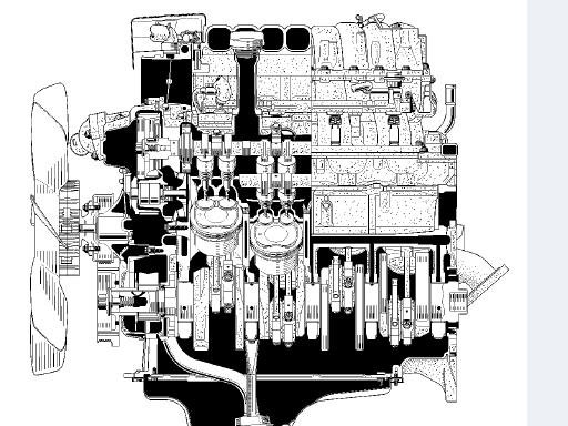

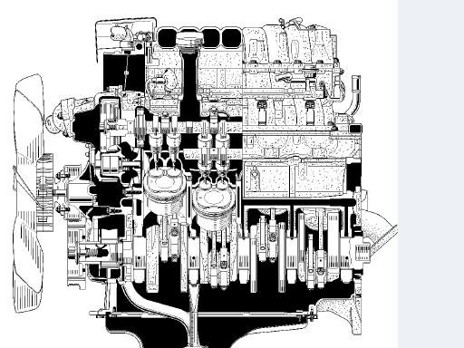

I have the screen print from the Toyota dealer -parts #s and pics. From both the landcruiser and tundra... the landcruiser shows a rear sump pan in the pic as well as the upper oil pan that looks like a rear pan set up ..... here is the odd part- the tundra pic has the front sump pan in the pic as well as the upper oil pan for a front sump, but BOTH have the same part #s!!!(upper and lower pans) the pics are clearly different from one another in many ways, maybe I will have to dig deeper into this. (crawl under a LC100 and look for myself)

AHHH!! I found a pic of one (courtesy of sleeoffroad- thanks Christo!)
THE LC has a rear sump on its 2UZFE.... hope this pic loads.
the front of the vehicle is on the right hand side of your screen

I corrected you, you were wrong.:sad6: dont ban me!!!! LOL kidding!
Maybe this can be added to the oil pan archives- that the 100 series LC has a rear (I beleive it isnt a middle one?!) oil pan and sump.
sorry I didnt post the specs..... the 100 series has the 2UZFE and it has had this engine since the start of its production (98)
