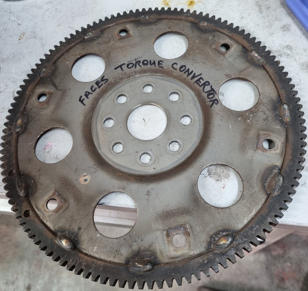

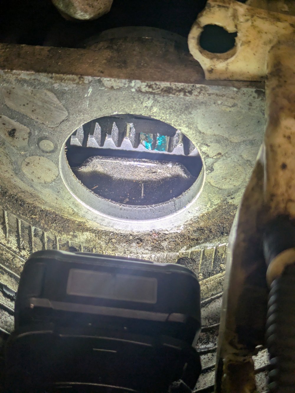

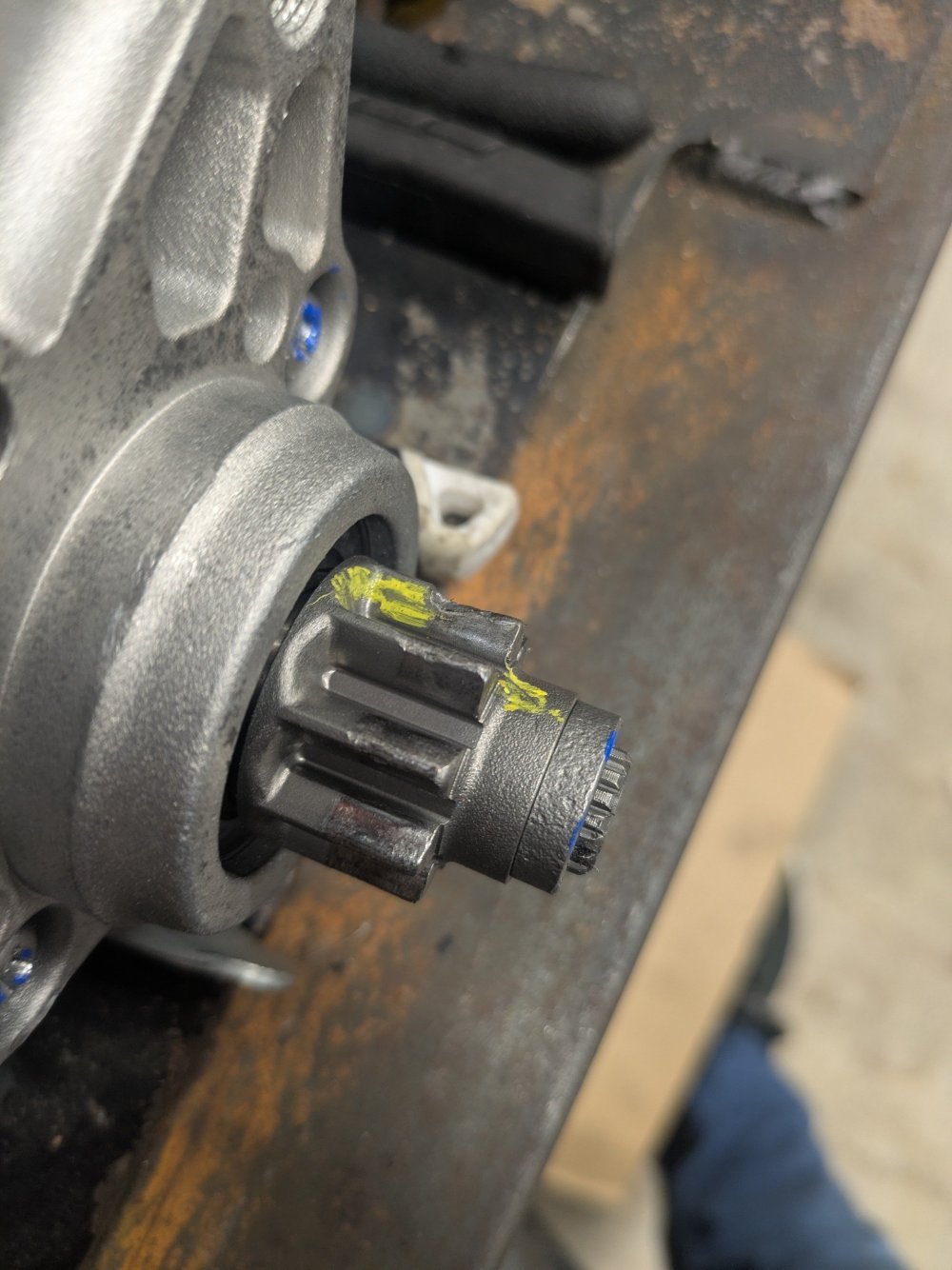

I keep burning through starters! They'll work for a little bit, sometimes even start the truck, with an amount of grinding and noise, but eventually all I get is click and spinning, no engagement. When I pull the starter, it tests fine on the bench and the teeth look alright on both starter and flywheel. I'm pretty certain I used the "guide" when installing the flywheel correct, and a new starter will work for a few starts before giving me the same issues. Any ideas where to go from here?
