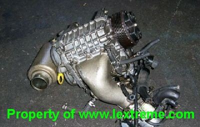

I have read in many places that those SC14 supercharger can last as long as 300,000 miles. I know there are few guys used two of these superchargers on the 1uzfe. I know a local Japanese Import shop sell them for like $95 USD each. What do u guys think?

i was going to put on on a 1UZ ages ago and someone on here did the maths for me and i would need 2 to make it effective - it ran out of puff at about 3500 from memory.
I think you will need two to make it work well for the V8. I have one in my 2.4L and full torque at 1,500 rpm.
With the 4.0 and power by two SC14 with 3.5" pulley will be optimal. Anything smaller 3.5" you will over spin it. Right now with my 8.9:1 at 4" pulley yield 8 psi and that is reach during 1,500 rpm.

Yup you would need 2 for any half decent performance. Has been done here in Oz and went quite well but a very complex setup and much easier ways to get the hp. The SCs are cheap but i still think a simple single turbo setup would work out cheaper all up and work better too.

I have one of these that I will sell for $75-it should have the front bearing replaced before further use. I used this on an autocross E-mod Miata for a few years and it worked very well. To reply to another post---this is nothing like a Rotrex,which is a centrifugal blower. Go to www.boostedtundras.com to see a pic of one that I use on my Tundra Kit.
The SC14 is a positive displacement blower just like the Eaton style blowers. I can give dimensions if anybody is interested
