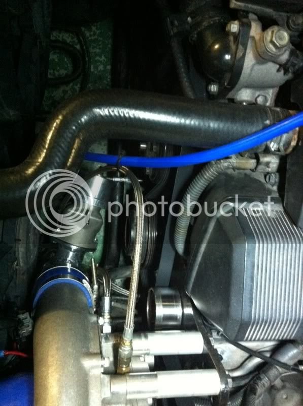

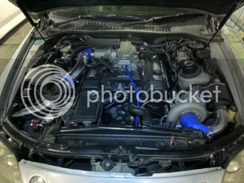

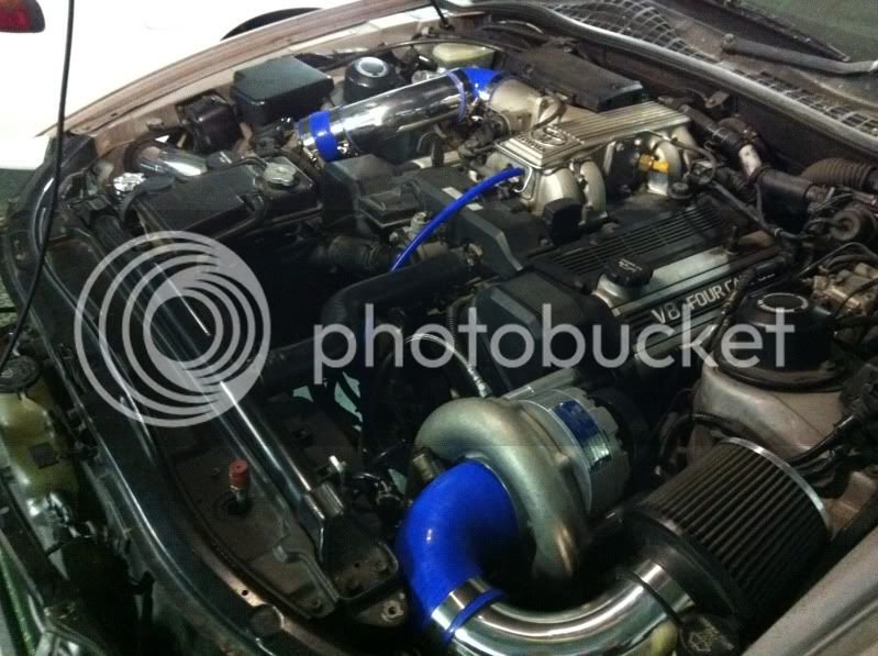

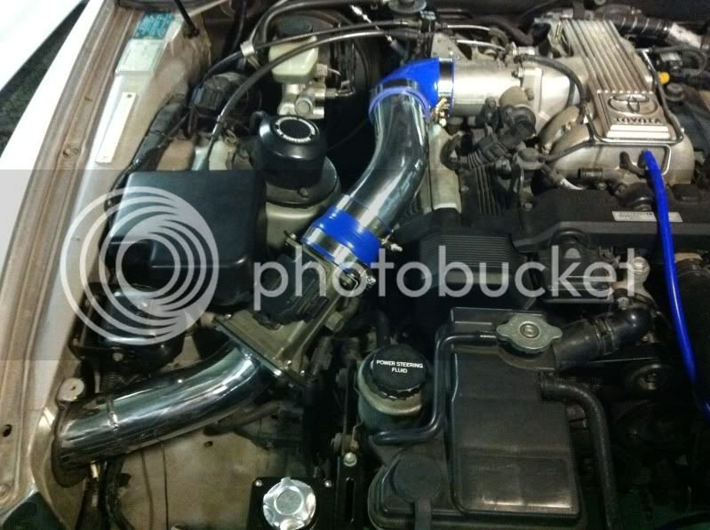

Hey congrats! Fitment and quality are right on. Nice job on the fuse box flip-flp... looks much easier/cleaner than extending everything.
Small tip, if you clock the blower inlet pipe under the headlight area you'll shed a lot of heat soak. I know your fuse box is right under the blower but there should be some roof left over.
Any pics of the exhaust setp?
Make sure the idle speed valve is closed, could be where the boost is going ;-).
I still have mine unaltered and I wonder why I dont see boost unless im WOT. Is there a specific input that keeps the valve closed? Thanks for mentioning that Cobber.
thanks guys, those pics where before i finished her of on sunday, Cobber is right their was a lot of unmetred air going in through the IAC valve so i did plumb it into the pipework.
the intake setup is only temporary i will be making the intake 4inch and most likely making some sort of cold air intake.

It depends on where the idle speed picks up it's air. If you have it open like in the pictures above it will leak out under boost. If you hook the air inlet pre throttle body post supercharger it will work as it should.
Depending on the ecu you an command the icv to also go to zero if > 100 kpa.
I am proud to supply you THE FISH. Great job and your car looks fantastic. Once again, Congrats... also make sure you plug up the TB outlet to the valve cover on the right...
