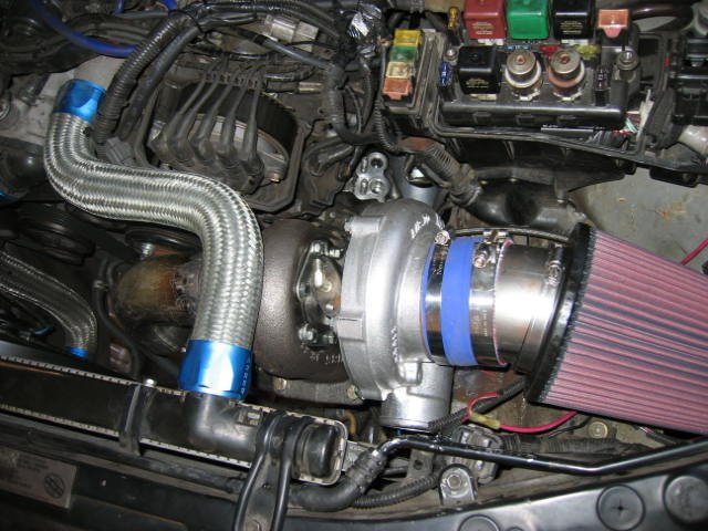

Here is a picture of single turbo. You are looking from the rear to front view. Since the Soarer has the same setup as the LS400 because the steering rack in one the RHD, its not an issue. Basically, this will be the same as the Soarer. The battery need to be relocated in the trunk.

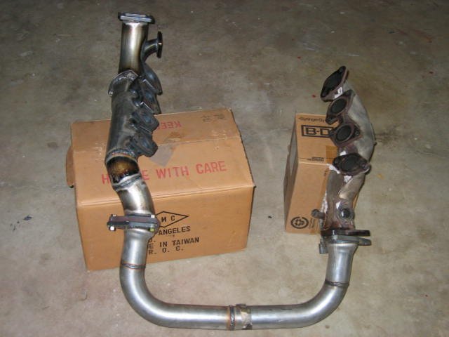

Here is a picture after the header, turbo and partial down pipe installation:

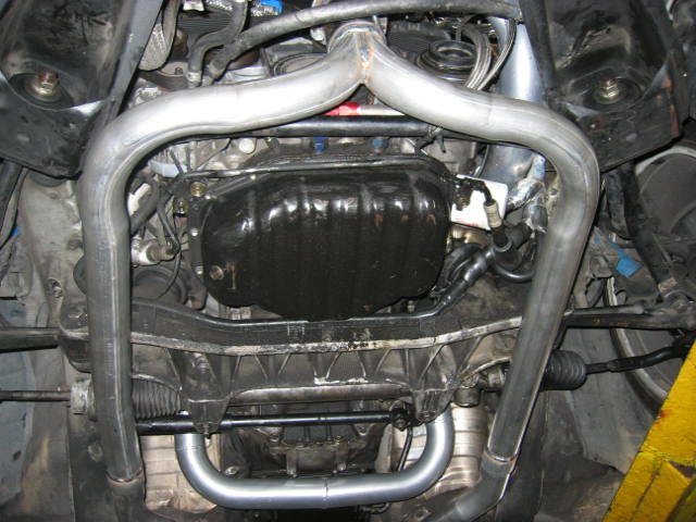

For down pipe, this can be done like this
When i was talking to Loaded (Steve), we discussed this system would be bolt right on for the Soarer due the RHD, but the SC400 due to the steering rack.
I hope this thread will provide some motivation for some of you hardcore must have FI people.
