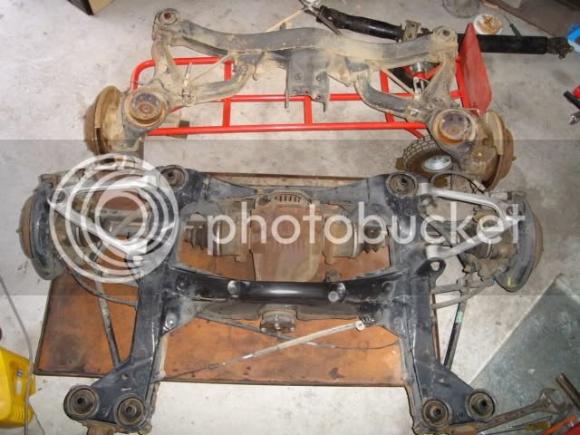

Here is a 2nd gen vs 3rd gen Supra rear end. MK3 is front.
LSD were only in turbo's and N/A's that had the sport package (i.e. TEMS)
Manual or Auto did not make a differance. The other thing is what year car is it out of? There were 3 different ratio's that were used...
Lastly, if your putting down good power and getting good traction, the MKIII rear sub frames need to be braced up as they are known to crack.
Either way though, 150 is still a good deal for it complete....

I picked up the IRS (JZA70 Supra). In GREAT shape I might add. I measured thee INSIDE width between those two parts of the subframe that stick out far forward. I needed to see if they conflicted with the chassis 'rails' on the underside. Inside width was 30" about. I measure the OUTSIDE width of the chassis rails...28in. Holy **** they clear! And they WONT stick out of the body lol. And the bast part...see second last photo... oh yeah $150...the bushings even look to be in good shape.

Hella deal for $150.... From the looks of it and its lack of two braces, it came from a 86-88 car.. If thats true, then its either got a 4.30 or a 3.909 rear gear depending on if its from a turbo or N/A car.
About the bracking that I said in my earlier post, the are known to crack around the diff mounts. If you look on the different supra forum and search for a guy by the name of NashMan and in his build thread, he has a really good right up and decription of the problems and how he braced it up.
Your welcome.
I also really positive now that that sub is from an 86-88 car cause it also has the early style swaybar endlinks.
Chance are that diff is going to need to be rebuilt. Luckily though, the disks, plates, and springs from toyota are not to badly priced and they are pretty easy to rebuild too..
