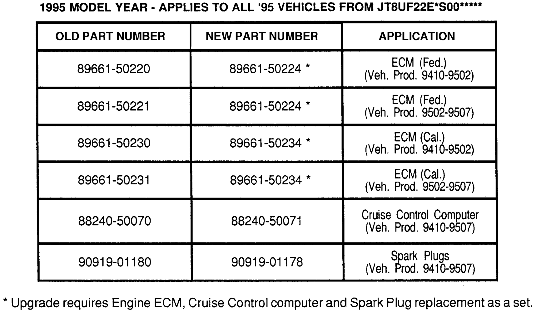

To improve driving smoothness at speeds above 40 miles per hour, the components have been changed.
t
does any one have any information on this. I have since updated my ecu with the updated one . I haven't had any issues since , but before after a 30 min drive I would lose throttle response completely. I would have to let off the throttle and coast to get to 40 mph then the throttle would be fine , until getting up to speed and it would do it again
