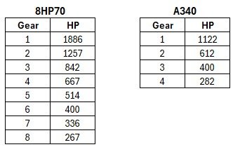

Currently, with 400hp at the wheels, the gear ratio multiplication equates to a theoretical:

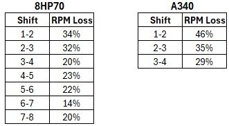

Further to this, with each gear change, there is way less RPM drop, keeping the engine on song

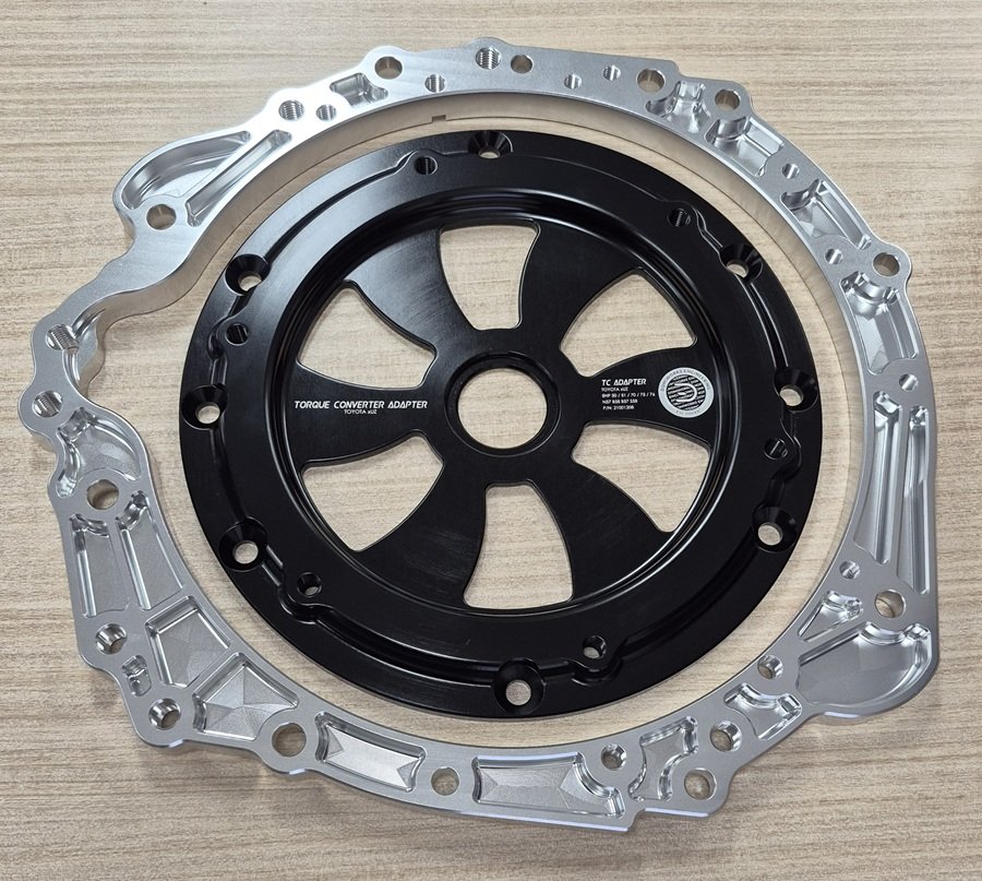

The installation hardware arrived today, and pictures don't do this stuff justice.
The quality is exceptional and it's a shame it will be sandwiched between the engine and gearbox, out of sight.

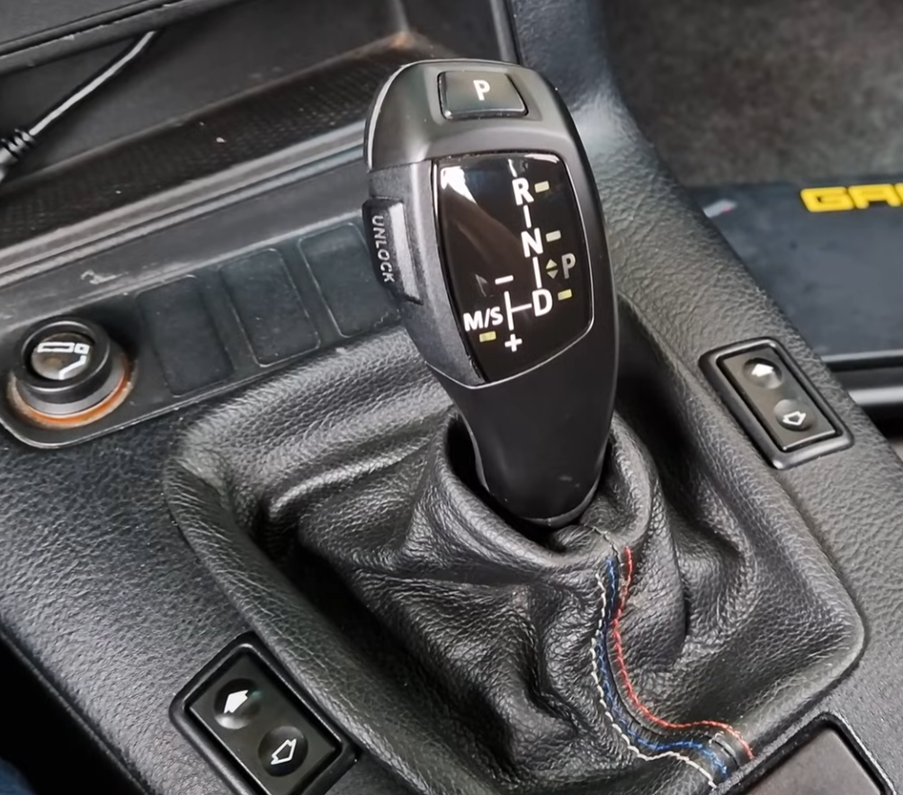

Shifters can be as simple as a 2-way rocker switch, or there are some stunning billet & carbon fibre shifters out there for megabucks. Most BMW CAN-based shifters are native to the software, and the harness is pre-wired for the OEM connector. I've gone with a 7-Series unit out of a wreck that will fit nicely into the console and won't look out of place.
