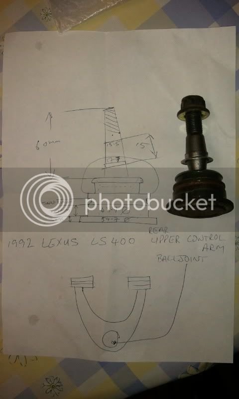

hi guys im new to this forum im wondering if anyone here supplies or knows of a replacement for the rear control arm ball joint its easily pressed out but toyota/lexus only sell the complete thanks.
22 views please tell me this is not another ls400 forum with no answers this is a regular wear and tear item im lookin to replace the balljoint only as its easily removed from the control arm which has mint bushes btw thanks in advance

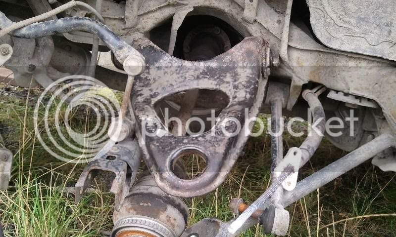

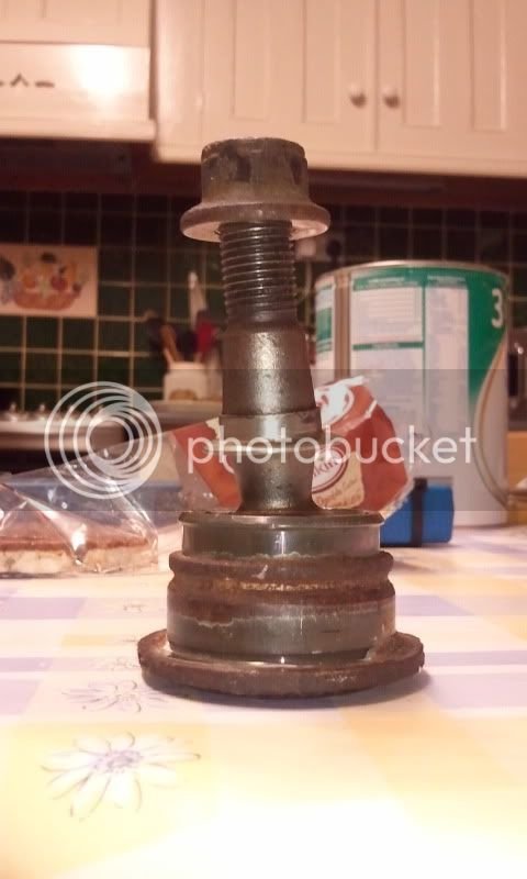

Registered just to post this, as I've been struggling with finding any info on it myself... I just replaced the rear upper balljoint on my UCF10 1991 with a replacement part meant for UCF20 (1994-2000).
It fits, apart from one detail, the snap ring groove ends about 1mm higher. I ended up grinding some metal off the control arm from underside of the seat.
