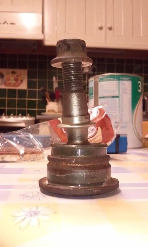

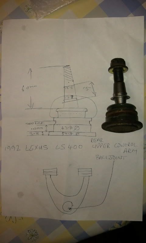

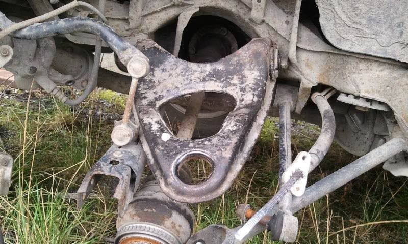

Registered just to post this, as I've been struggling with finding any info on it myself... I just replaced the rear upper balljoint on my UCF10 1991 with a replacement part meant for UCF20 (1994-2000).
It fits, apart from one detail, the snap ring groove ends about 1mm higher. I ended up grinding some metal off the control arm from underside of the seat.
