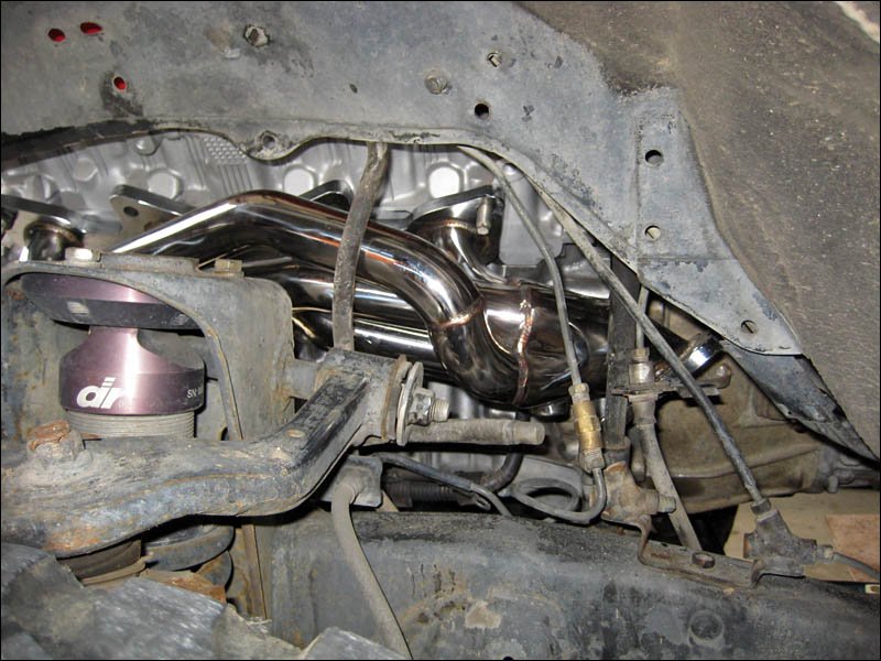

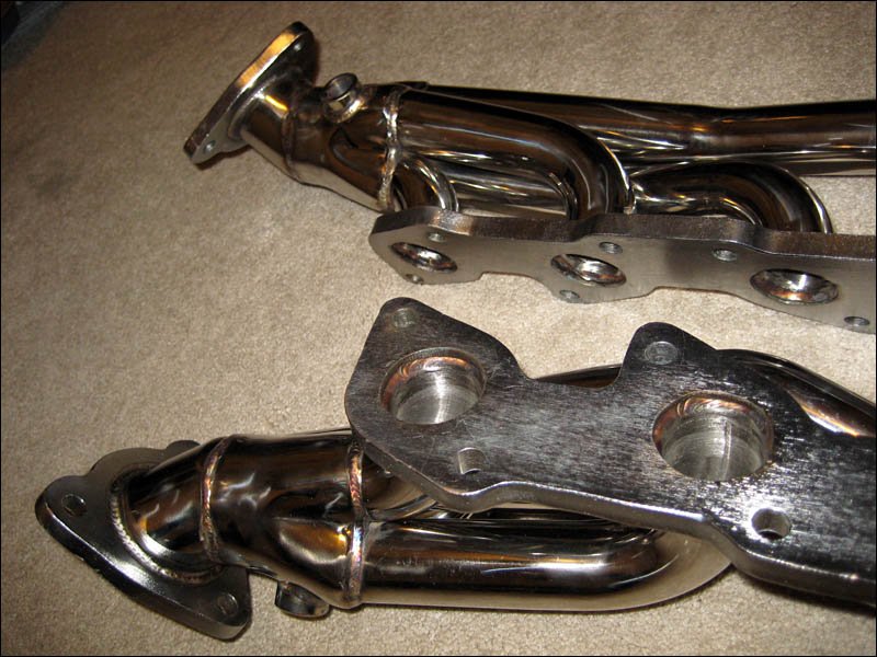

Just by the cheaper ones. I'm sure they are the same mfg. or at least same quality. I bought some and they are awesome. I was very surprised by the high quality of welding and the flange is much better than the average header flange. Here are mine on the drivers side of my Tacoma. This is before my engine is bolted to the transmission bellhousing since I'm waiting on my adapter plate (hoping to have by the wknd). I just put the engine approximately where I thought it should be and the headers look like they were made to fit in my engine bay. I have a 2.something body lift I made and they collar of the steering shaft might hit the header when it spins maybe. No matter since I'm extending the steering shaft today with a flex joint to get rid of the cheesy adapter I made when I lifted the body. These headers are awesome for the price. The flange would cost 120+ alone.

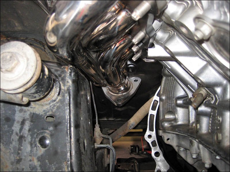

Not sure if they fit an SC though. But they are so cheap that someone needs to try. :reporter: This is the best I can do for ya. Not an SC but you can see the profile of the headers in relation to the engine.

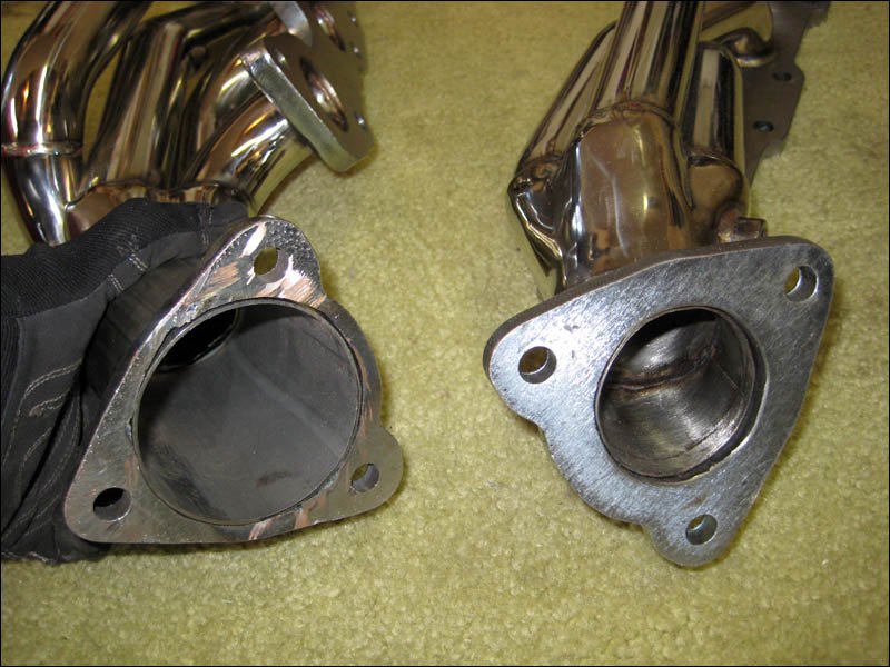

The trouble I had with mine is getting a good seal on the exhaust flanges. They're a 3" 3 bolt size flange with a 2" hole. I ended up (yesterday!) giving up and cutting the flanges off, extending the main section down further and changing to regular 2.25" flanges...

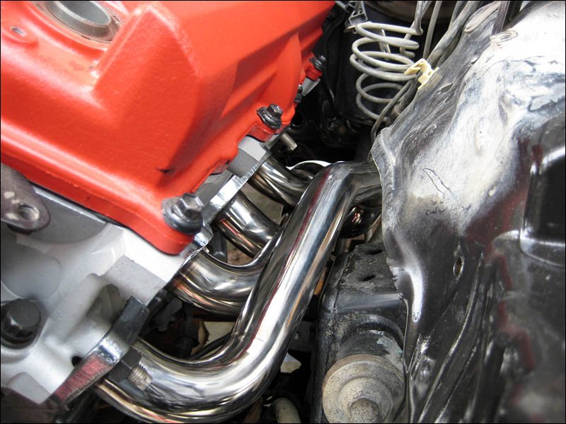

Member Chrisman used them reversed and modified for his twin turbo sc400 without a/c.
http://lextreme.com/forums/showthread.php?t=2377

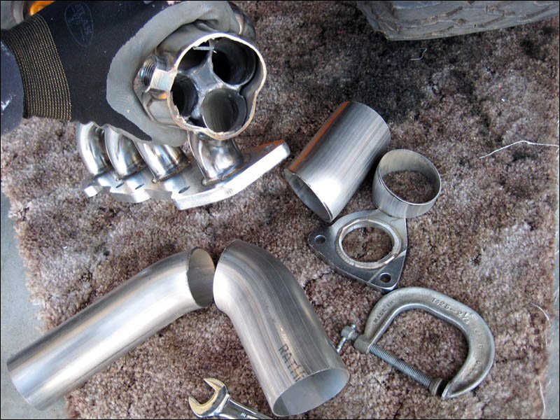

Here is a look inside at the collector if anyone wants to see:
While I'm cutting mine to make them clear my Tacoma steering shaft I couldn't help changing them a bit:
Yeah that's huge. I changed mine just recently to 2.25" because the flange outlet was only 2" if that. Mine is now matched to the 2.25" Y section size.

The outlets on mine had 2.25" OD pipe diameter. I changed mine to 2.25" ID pipe to match the front Y.
