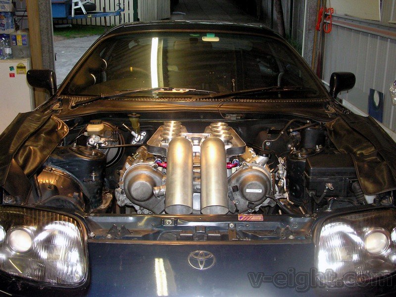

my project is a 1979 323i bmw (e21), with 1uz, w58, (on custom engine and gearbox mounts) using custom adaptor onto auto bellhousing, hydraulic clutch release bearing setup, MR2 turbo (3sgte) flywheel (modified ring gears and centre), custom 5 puck brass button solid centre clutch, custom (one piece) driveshaft to a Skyline Gts-25t diff (4.3:1, LSD), custom axles, custom hubs to change from 4x100 pattern to 5 series (5x120 pattern), bmw M5 replica wheels (17"x8"), lowered springs, adjustable shocks, 540i disk brakes (13" fronts) and willwood superlite billet 4 pot callipers (fr), toyota callipers at rear (to simplify handbrake system), incabin adjustable (fr-r) willwood pedal box with tilton mastercylinders (no booster setup), all new brake lines (run through car rather than under, and none go through the engine bay), custom made braided brake hoses all round, Skyline radiator, alloy radiator hoses, polished cam covers, modified and polished intake plenum, modified throttle body (cut up to remove traction control stuff), K&N pod filter (directly mounted to throttle body, no MAF sensor needed with Link computer, it uses MAP sensor), removed air con and powersteer pumps and belt, re-mounted alternator and new (much shorter) belt, Bosch motorsport fuel pump under custom fuel and surge tanks, malpassi adjustable fuel pressure regulator, engine bay completely de-loomed (fusebox moved inside cabin, all wires hidden and re-routed around engine bay
other modifications include: big sounds, tints, Recaro reclinable front seats (mitsi gsr spec), stripped out interior of all carpet and sound deadening, replaced by custom treadplate mats, de-bumpered, shaved badges and handles and fuel filler flap, modified rear end, and some other stuff i can't really remember right now.
so far its taken me two years, with only the Link computer and tuning, and exhaust, and a few (lots) of other small things to finish. i hope to run low 12s when done, and do lots of drifting. then maybe some forced induction, or NOS, to see if it'll do tens without the gearbox blowing. Now to find some money....
