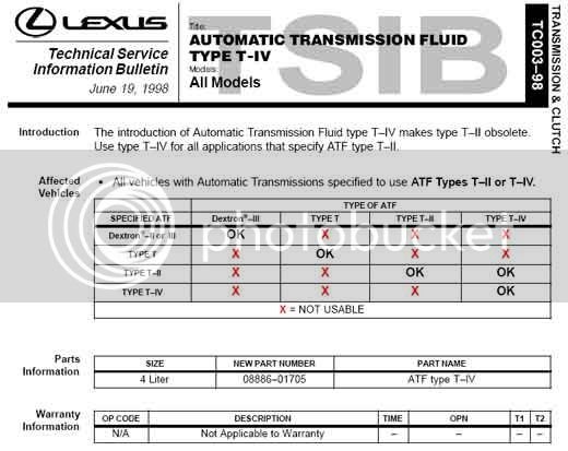

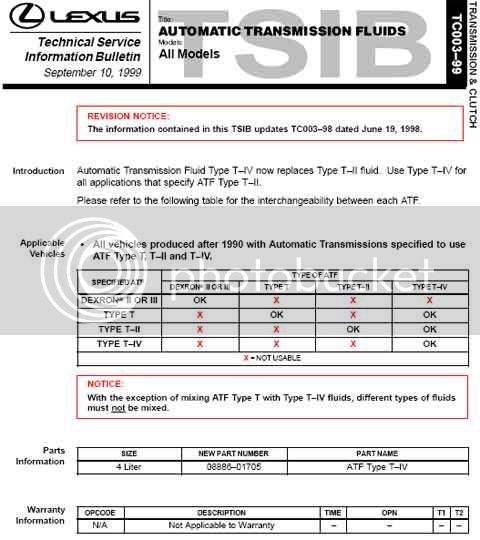

I think that's a bad idea. TT-IV is
NOT a replacement for Dexron specified transmissions. While Toyota is generally behind the curve in lubricants, they are very good at rating lubricants. They specifically state in the TT-IV tech primer that TT-IV should not be used on Dexron transmissions, and original TT-I transmissions. They would stand to make alot of money in dealerships if it was.
Dexron isn't compatible with any TT fluid.
Personally, I believe them.
