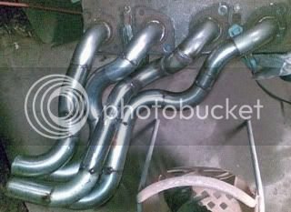

This is the drivers side headers i've made for my Torana conversion.
The're only tacked at the moment. I'll have to borrow the TIG from work one weekend to weld them up.
It's a bit of a tangle as there is not much room.
I might try to reduce the number of bends at some stage.
I found that i could cut the standard uzz31 headers, most of the way through, at the end of the manifold flanges and bend them down a bit, gave me enough room for the steering shaft. and the engineer at work rekons the're made of inconel, heaps better than stainless
