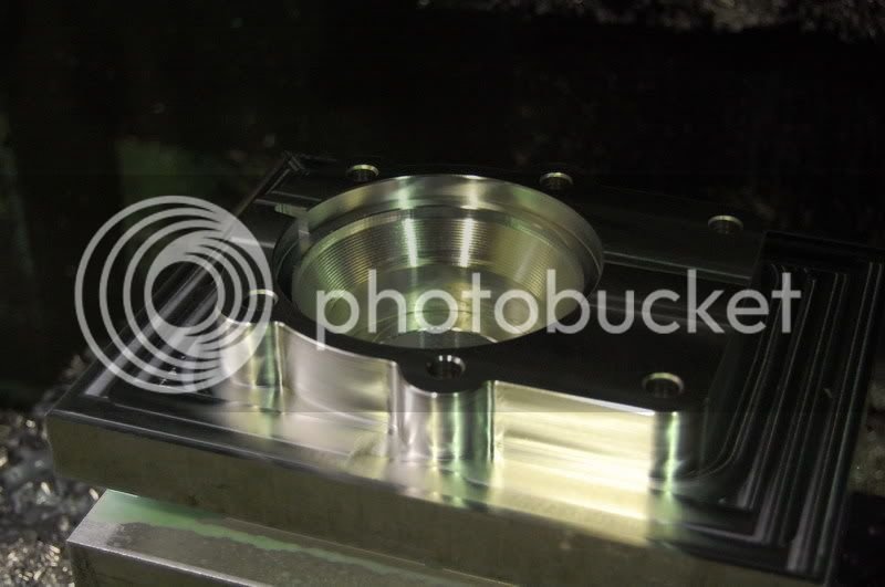

Righto, we've all seen the pretty pictures from the cad system, now heres some pics of it turning into the real thing

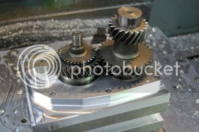

A bit more CNC porn for ya :mrgreen:

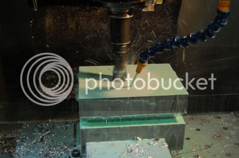

Here we go then, no turning back now.....its only a $650 chunk of alloy

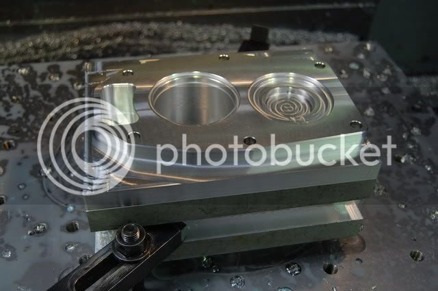

Drilling a big hole through it

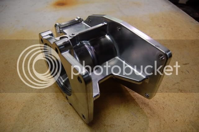

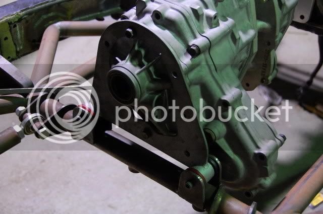

Ist operation is done, this is the end that bolts to the back of the trans

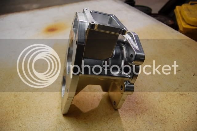

couple more of the transfer case side
Got it finished last nite

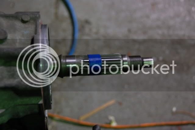

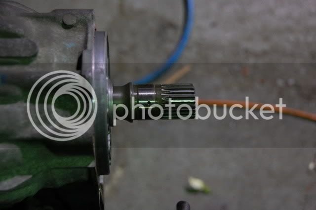

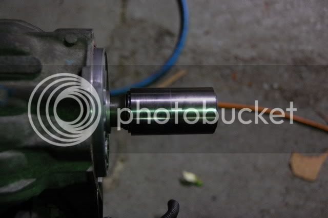

Cut the output shaft on the auto
Tapped the coupler on

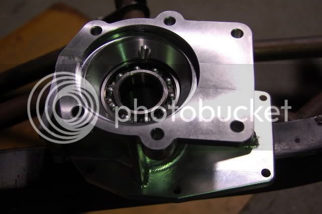

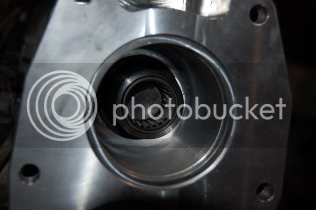

Installed the bearing and seal into the housing

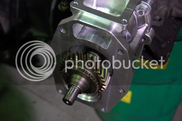

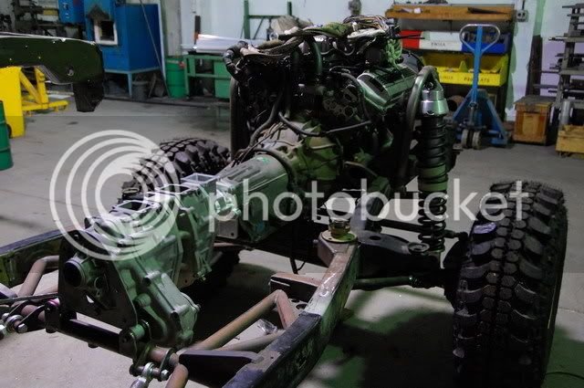

bolted it up to the auto, heres 23splines waitin for some input :D
And here it is, 23spline input shaft

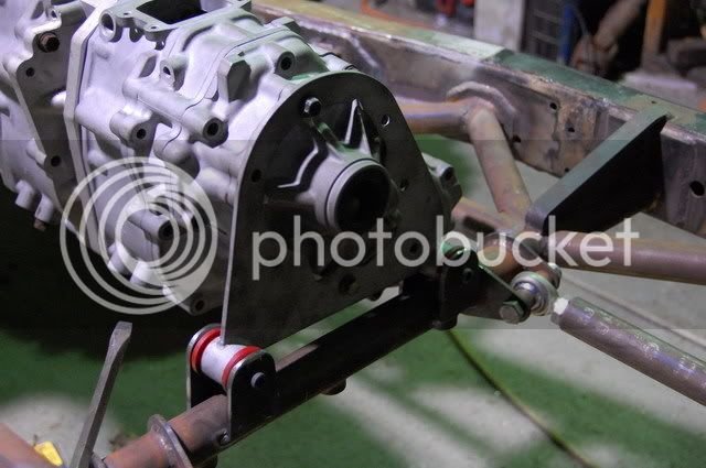

Also made a rear transfercase mount, kinda "Front Range Offroad" styles
Holy blingness :love: are you going to sell these? looks alot cleaner than the one i ended up getting, what is the overall length? looks shorter than my one as well.
Came out at 145mm long. After some thrashing on the rocks to make sure it all works fine, we'll be selling these units. It'll include a cast adapter, a 23spline coupler, 23 spline input shaft, speed sensor trigger, bearing and seal etc to allow you to just cut the output shaft and bolt it up and go. We will have more info on pricing etc later on.
